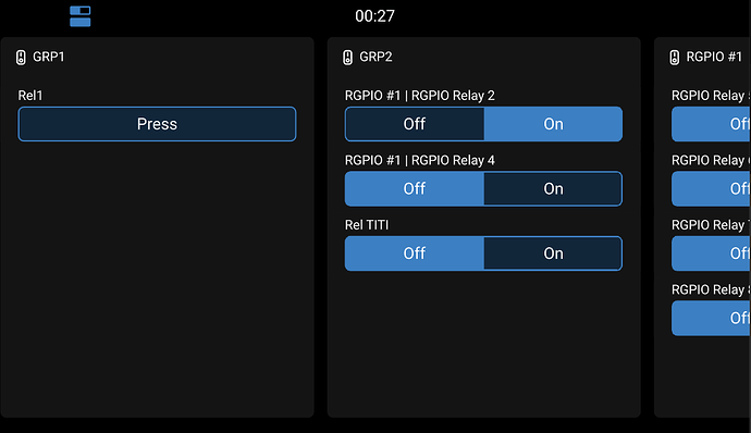

The DigitalInputs are handled at kernel level with no polling process (better CPU footprint) and exposed like any embedded DI of a Cerbo GX.

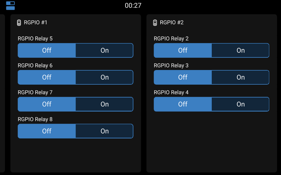

The Relays are also working like the new GX IO Extender 150 with the Venus OS gui v2.
The driver is native DBUS. No needs to run Large image with Node-Red, but Node-Red can play with the additional DI and Relays :slight_smile:

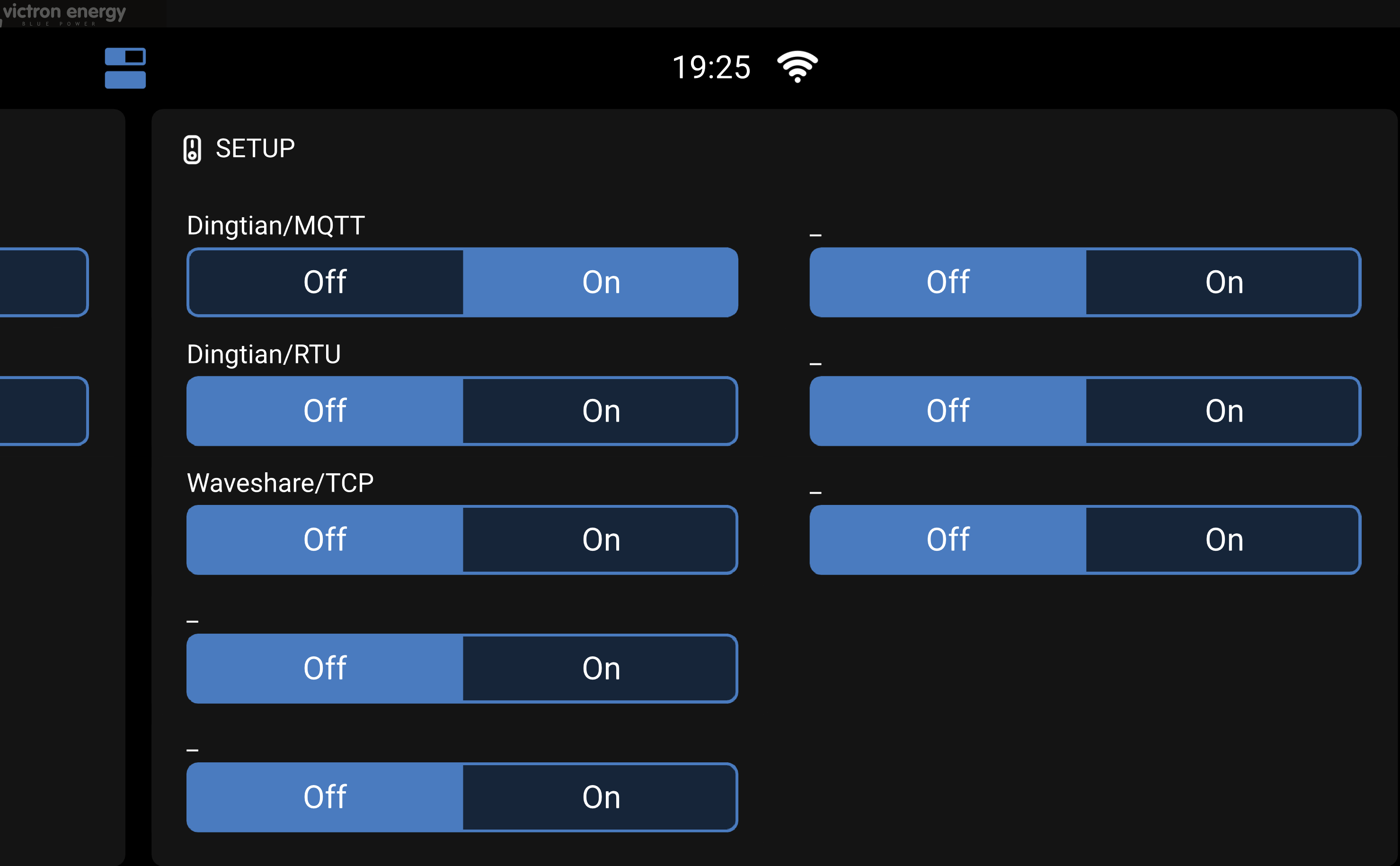

The objective is to handle everything dynamically with zero configuration file editing, with a Virtual Switch configuration to select the running modules.

Using a virtual switch to configure RemoteGPIO against installed hardware

Hi there, I have a question. I use a Dingtian relay box with an RS485-to-USB connection (which I learned about from the forums here), and it works fine on GUI v1. Does this update also include support for that? I updated to the beta, and I can see the extra relays, but I have no control over them.
Hello, this is in my todo list to add a driver for Modbus control. This will enable the RS485-USB connection of the Dingtian.
