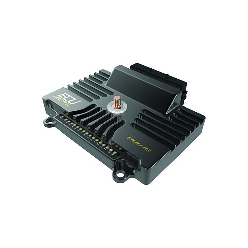

Ideally, I would like to use a system similar to this one:
This is a module that also communicates via CAN bus and offers a wide range of features, such as internal fuses, PWM control, and programmability.
Also a tip for Victron: it would be great if you developed something like this yourselves a module that integrates seamlessly with your existing product line.
