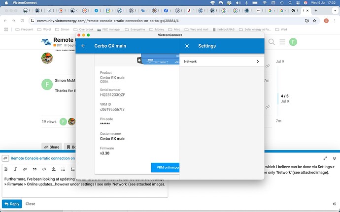

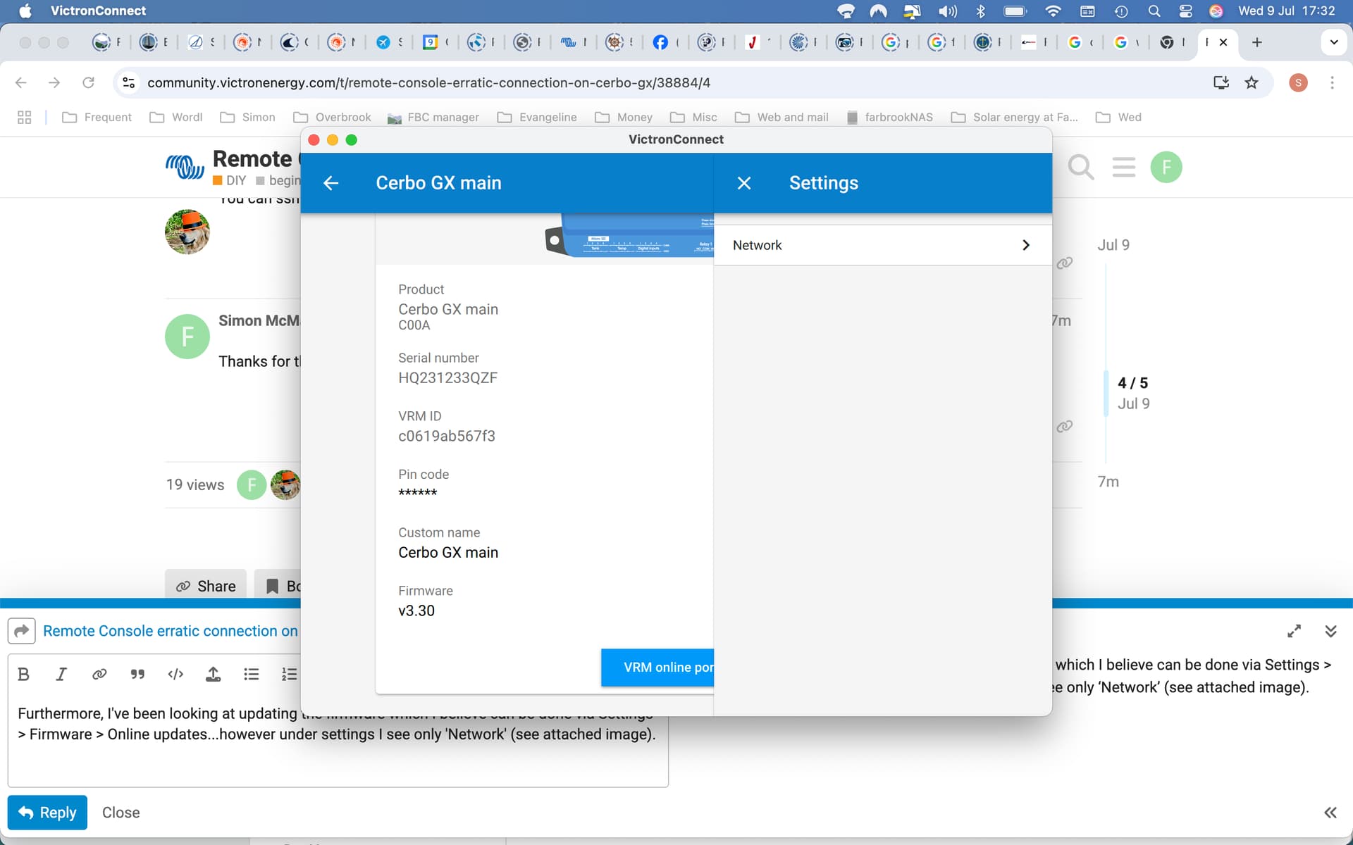

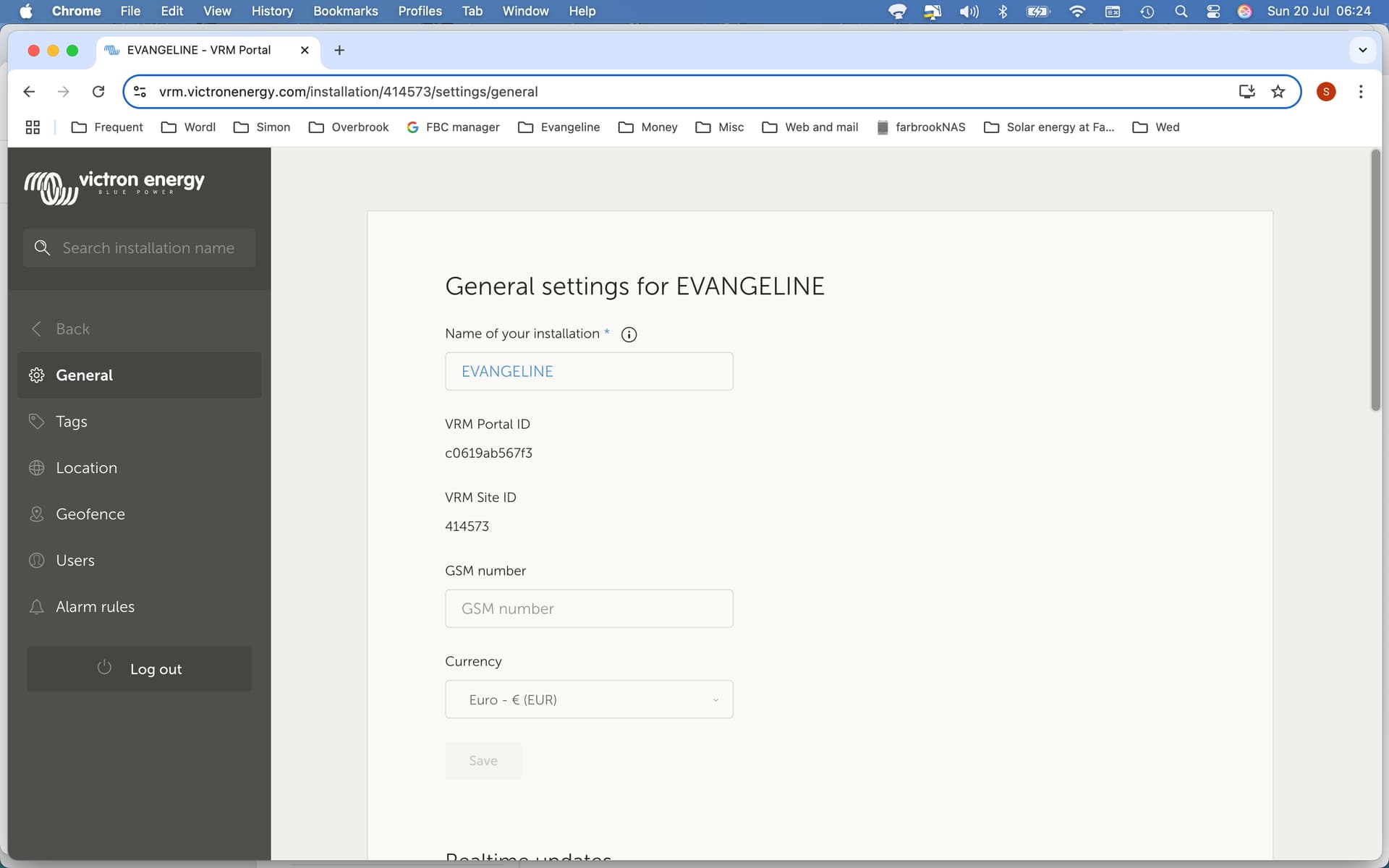

Furthermore, I’ve been looking at updating the firmware which I believe can be done via Settings > Firmware > Online updates…however under settings I see only ‘Network’ (see attached image).

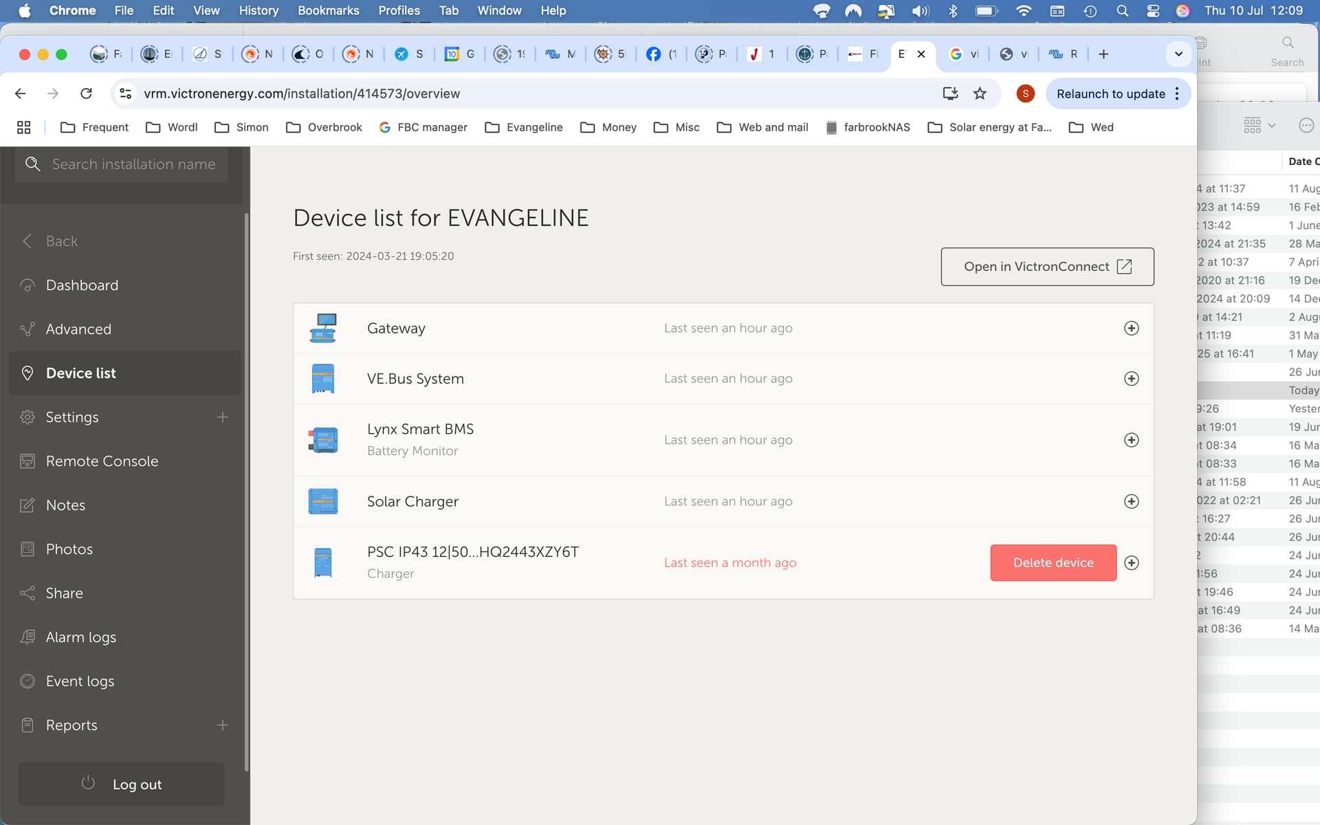

You can update your devices via VRM by Selecting - Device List - Firmware Update. The system scans your attached devices and after the scan displays all devices with their current installed firmware versions as well as any updates which you can select and update. Hope this helps I manage multiple sites and find this method extremely good.

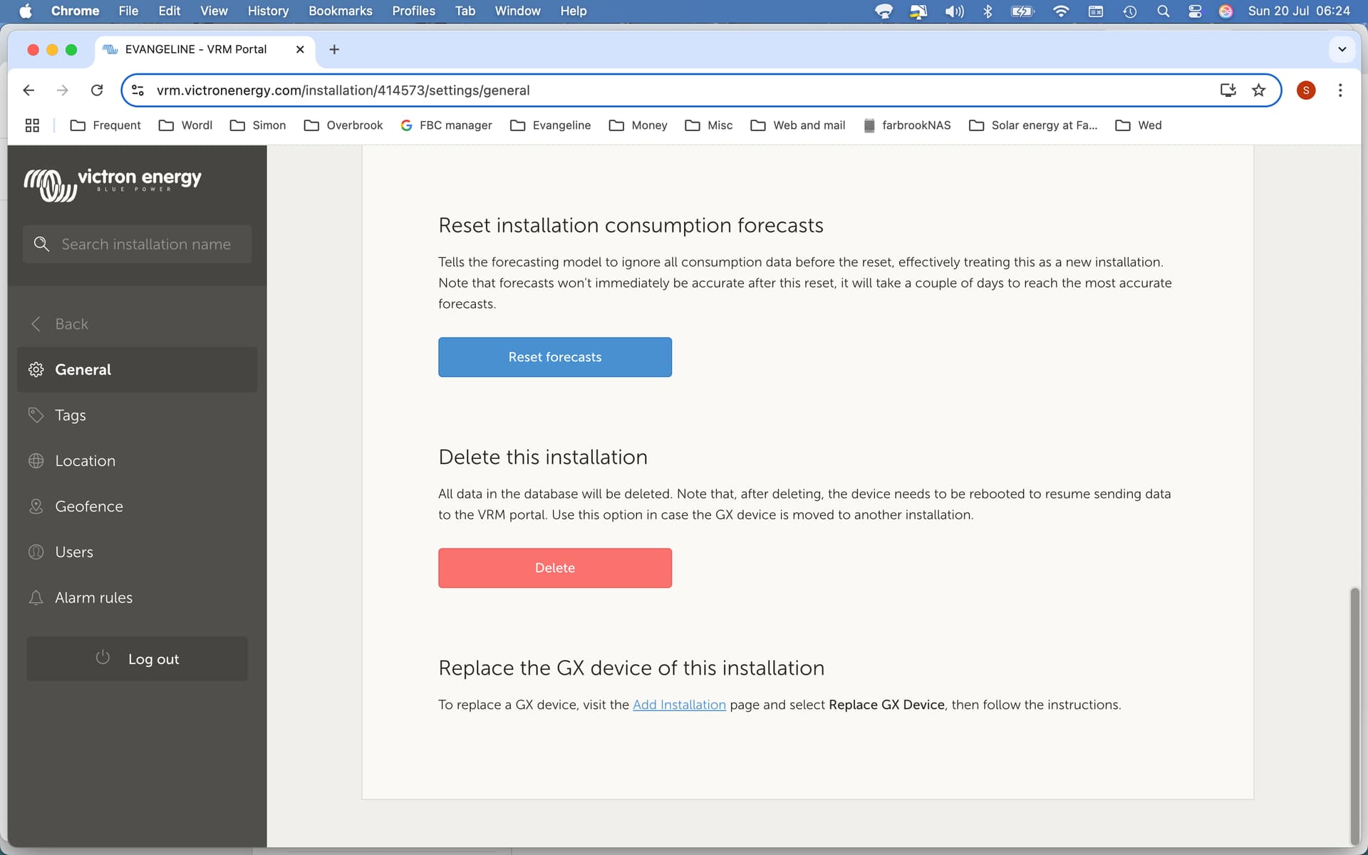

Many thanks for your suggestion, but I’m unable to access ‘Firmware update’ - the option doesn’t appear (see attached image). Any suggestions?

Hi @Farbrook ,
Sorry, I meant on VRM, like here:
Can you see that?
