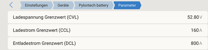

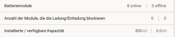

In May 2024, I installed 8x US5000 batteries for a customer.
They had a CCL/DCL of 80A each = 640A
After the firmware update this year, the same batteries now have a CCL/DCL of 100A = 800A
However, the 100A rating is also shown on the Pylontech website:
Hello Dirk,
Many thanks for the information. It’s interesting that the maximum CCL/DCL increases as a result of the firmware update, without any changes to the hardware.

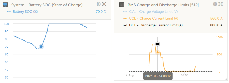

Hi Rolf,
As mentioned above, the new firmware reduces the CCL noticeably earlier, as far as I can tell.
Here is today’s data:
This could be related to balancing, but that’s just my guess.
Hello Dirk,
Many thanks for the explanation. I had also read before that the maximum cell voltage of the Pylontech batteries should be limited, for example by changing the settings on the Cerbo GX. Perhaps the new firmware version has resolved the problem.
