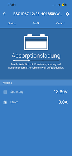

The solar setup itself isn’t causing any problems, and the battery is correctly detected and charged by the MPPT. The problem is with the charger: no charging current flows at all (0 A). Although the charger output is at 14.2 V (both when measured manually and as shown in the VictronConnect app), the battery simply doesn’t charge. Since it is currently at around 60% capacity, it should definitely be charging (it’s night-time, with no sunlight). The app simply shows: Absorption 14.2 V – 0 A.

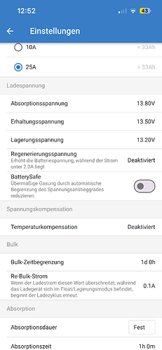

What is the BSC setting?
Hello, this is what it currently looks like, but I’ve tried various other settings without success

The no-load voltage is 14.2, and under load it is 13.37; the battery is at 89%
What is strange is that the charger switches from absorption to float, but no current is flowing

Personally for my redodo 12V 100Ah in series for 48V I keep things very conservative, absorb at 13.8V and float at 13.6V.
Absolutely no reason to try and get to 14.2V imo very little capacity at the top end. Chances are bms is disabling charging due to one of the cells hitting a high voltage limit.
Discharge the battery some then try those settings. The soc guessometer in the app can be ignored. Mine dont have any bt at all just black boxes.

Just connect a lamp to the power supply and see whether any power comes out at all. The fact that the output voltage is higher than the set 13.8 V when there’s no load makes me suspicious, and that shouldn’t happen with a charger like this.
If the battery isn’t fully charged, the voltage is pulled down.
Have you got any photos?
If the charger is set to 13.8 V but outputs 14.2 V with no load, then something is faulty.
So, the matter is settled: the device is faulty! I dismantled it and measured 13.5 volts; when I connected a 12V lamp, the voltage dropped to 0.
