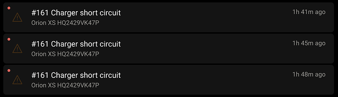

I have the same issue on a new install - customer gets the errors once a week, and then its fine for a long time.
I;ve seen this numerous times recently, all on latest firmware and relatively new units.
I have the same problem.
#161, #28, and #21
It won’t charge, it stays at 0. I turn off the Orion in the app, but it keeps heating up.
The seller hasn’t responded in 3 weeks. This is poor service and a bad image for Victron.
