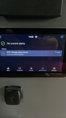

Continually getting an error code #161 short circuit orion xs , i have contacted my supplier who advised that we change the orion , with the new orion we are still getting the error code . Everything seems to be working perfectly on the electical system apart from this code showing. Any help would be appreciated thanks

Ive installed my 2nd orion xs1400 and I’m getting error 161 and now 28. Boat is on shore power with quattro charging lithium bank.and ip43 charging start lead acid. Software 1.13. Hopefully it will turn back on to get some history.
