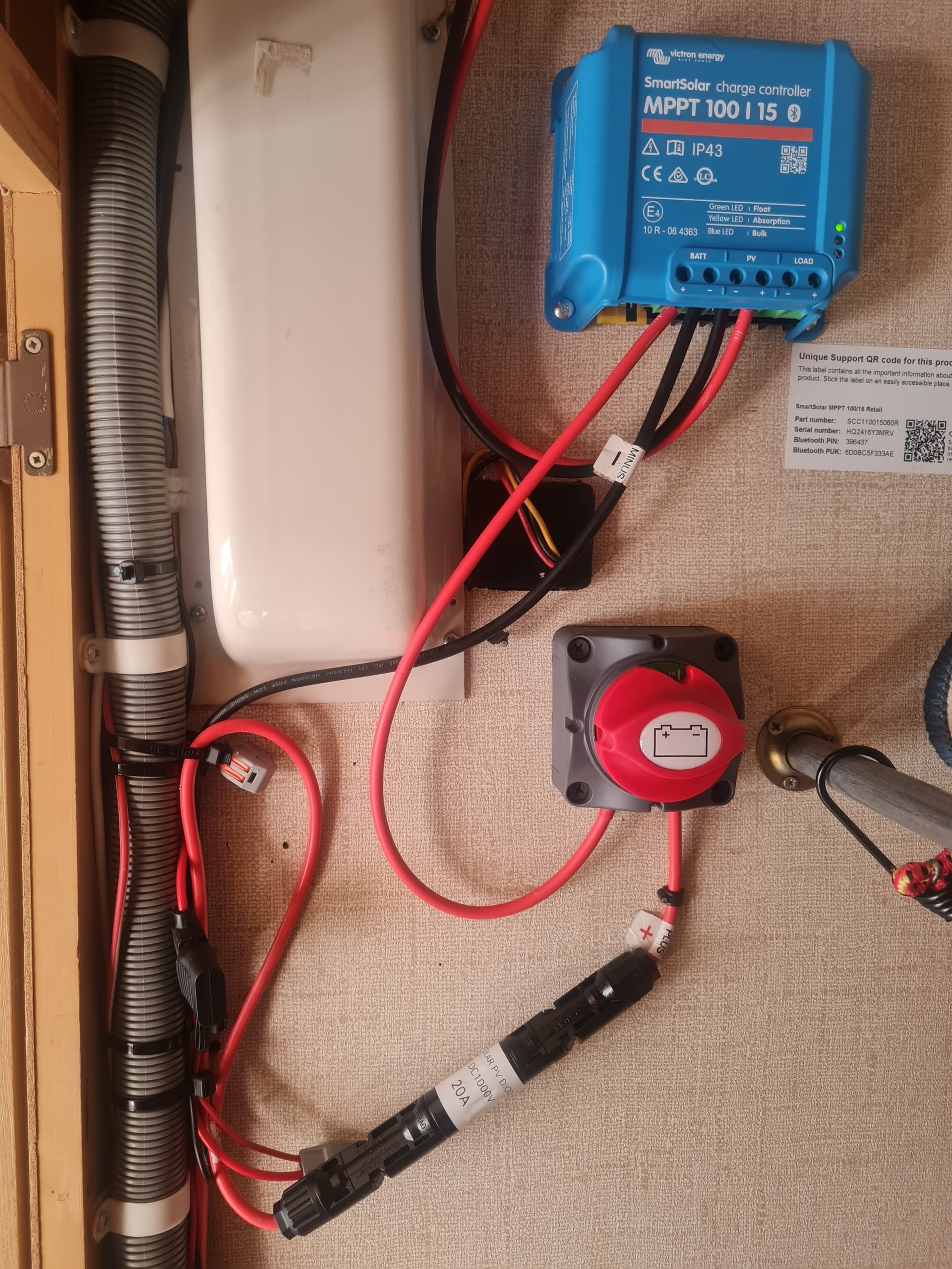

The vast majority of problems are poor connections, failed fuses or breakers between the MPPT and the battery if you see panel voltage but no amps. The 100/15 has a car type blade fuse built in by the terminals, check this is OK.
Check voltage at the MPPT terminals and the battery terminals with a multimeter, if the connection is good they should read the same.

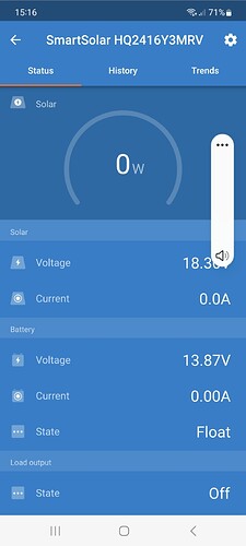

You could also add a screenshot of the status page as that often gives a clue.
Your solar voltage is below the 5V threshold needed to start.
With the battery at 13.87V you would need a minimum of 18.87V to start, you have 18.3..
The first picture was taken when the sun went in,here’s a new one with 20 plus volts on it,even it shown 22 plus there has alway been no current showing

The volts at the connections are the same as what’s showing at the same time as what’s on the App.
You also measure 13.8V at the terminals of the MPPT? What does the battery itself measure to, directly on its terminals, i bet its less. Check the connection between the MPPT and the battery, theres going to be something loose, disconnected, blown fuse
Check the inline fuse, check the disconnect (the can fail as well), then follow the cabling
(Also, MC4 inline fuse on the batteryside, thats a first for me)
I would temporarily remove the disconnect.
Measure at the battery and at the terminals of the mppt, if they don’t match you have an issue.
Do a test without the holders, switches, isolators etc out of the chain.
Something is broken..
Almost always it’s the wiring/connections.
A meter tracing it out will show where it is.
