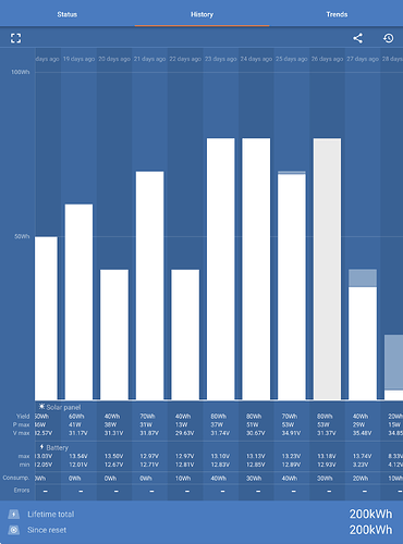

Have a look at the screen same as below for your setup to better understand things.
I am sorry, I am not following.
The table in the opening message was from the VictronConnect App History.
I think this is a good example:
- yellow: solar
- green: battery
- blue: load
As you can see:
- up to 12.00 it continuously charges, with
Absorption voltage (14.6V)
- after that, it goes down to the
Float voltage (13.5V)
and the total yield of the day is only 320Wh, far lower than the theoretical battery capacity 1320Wh (12*110).
Am I misunderstanding?
If the battery is full it will not take a charge and loads will be powered very much from solar. Your load is small so you never use the battery much it seems and it only gets topped up from what I can see. The history graph shows you a lot of detail or you can do as you did.
But if the battery is fully charged (even if considering a 50% efficiency 12*110/2=660Wh), why it can sustain a load of 15-20W for only 12hrs (16.30/4.30) circa 180-240Wh?
