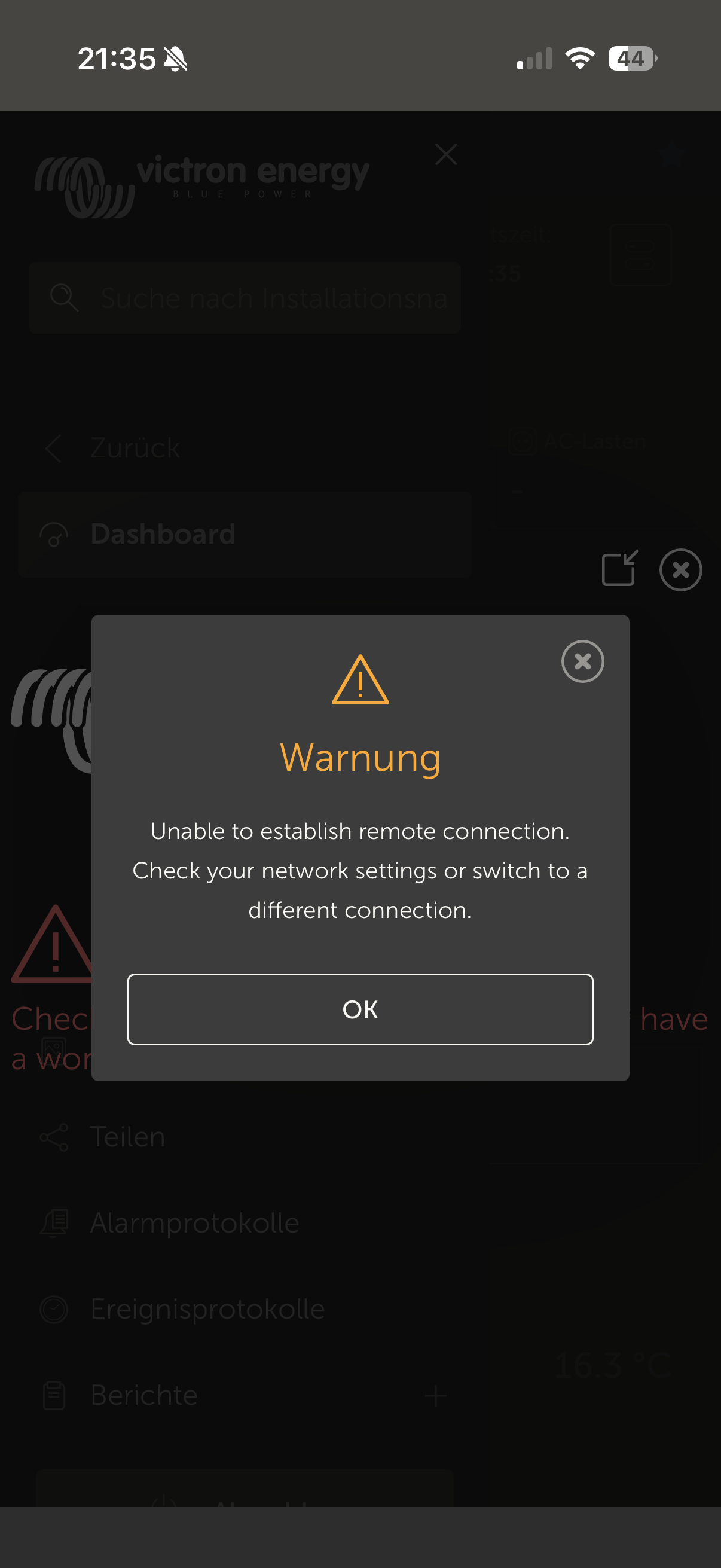

Remote console on Cerbo with Beta 3.70-34 is not working anymore:

sure, network is fine, reboot didn’t change anything, haven’t done a rollback so far.
Just tested the roll back to v3.70-33 and it is working again
