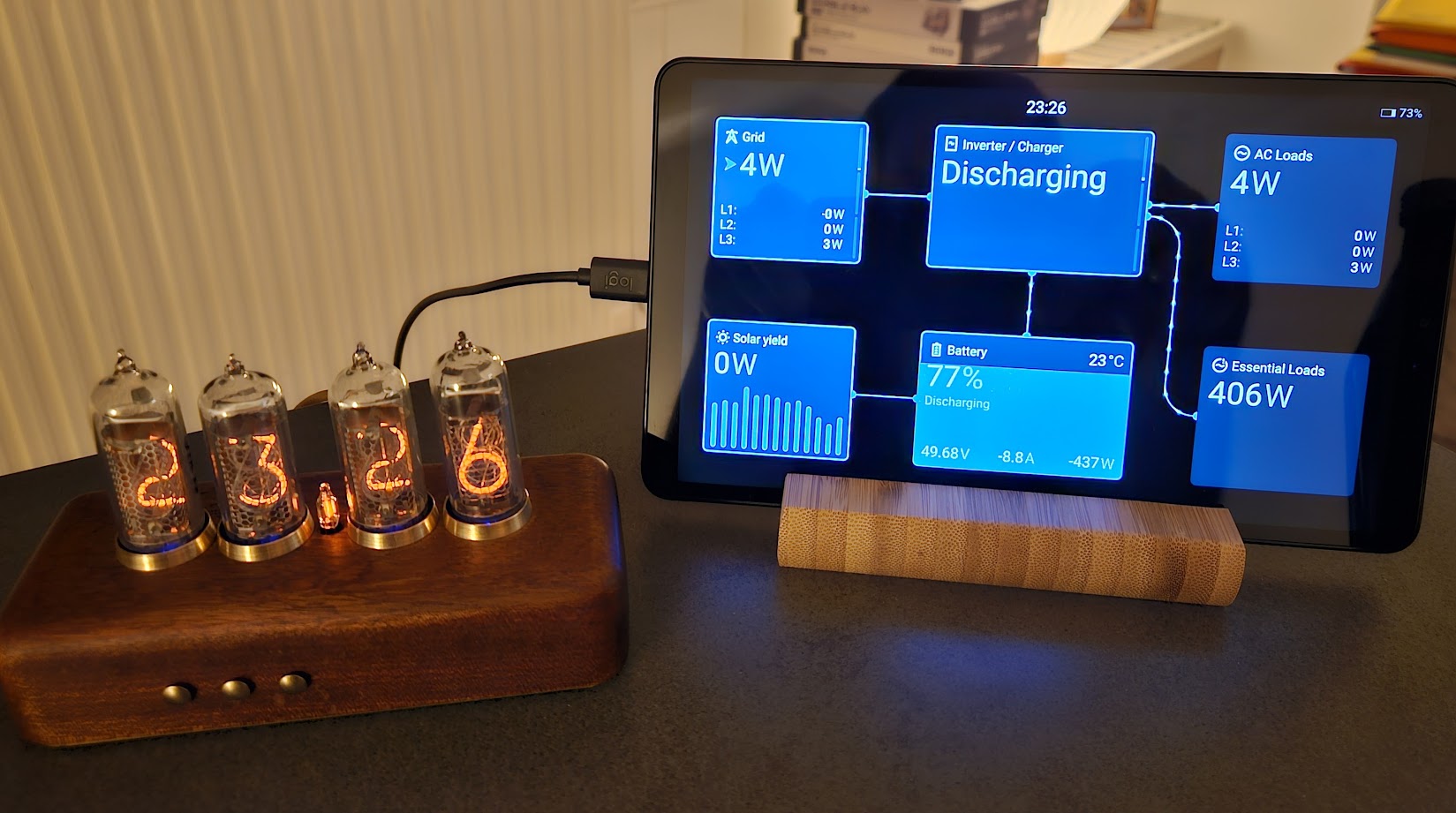

Confirm :slightly_smiling_face: Excellent quality and display size for a reasonable price.
[Update: 18.06.2025]: Running now for multiple weeks, no issues at all.
Maybe just one “cosmetic” finding: After wakeup, it shows the last information before going to standby - just for a second, starts re-connecting and shows correct view after re-connect. Maybe staying with your logo and a tiny “reload” animation would be better instead of the outdated information :slight_smile:

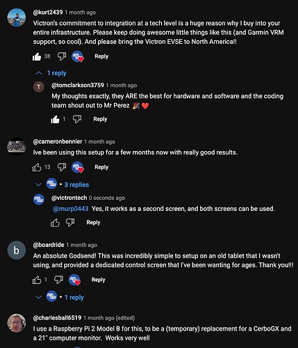

A few nice comments from the Youtube channel video for this feature :slight_smile:
Great stuf, I just set it up on a Samsung Tab A6 SM-T580. Worked first time, very good. I can’t get the service menu to open.
