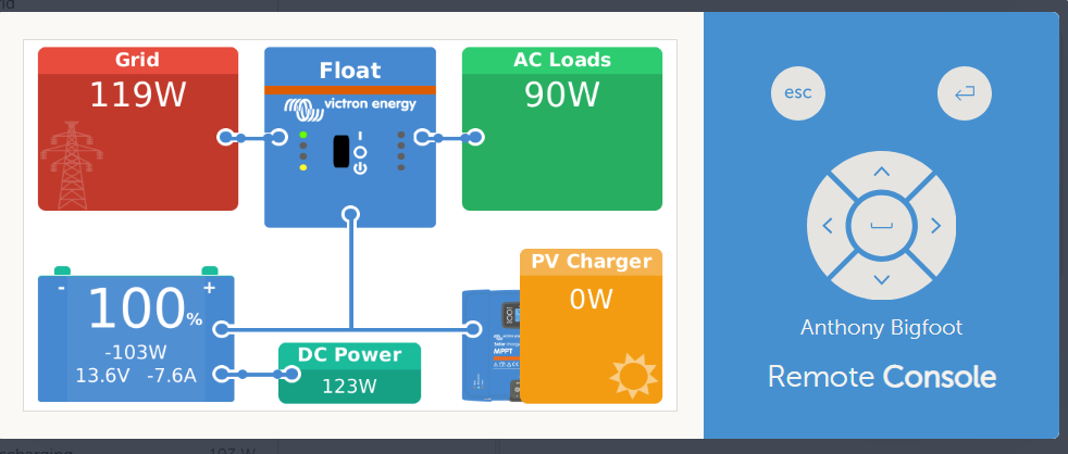

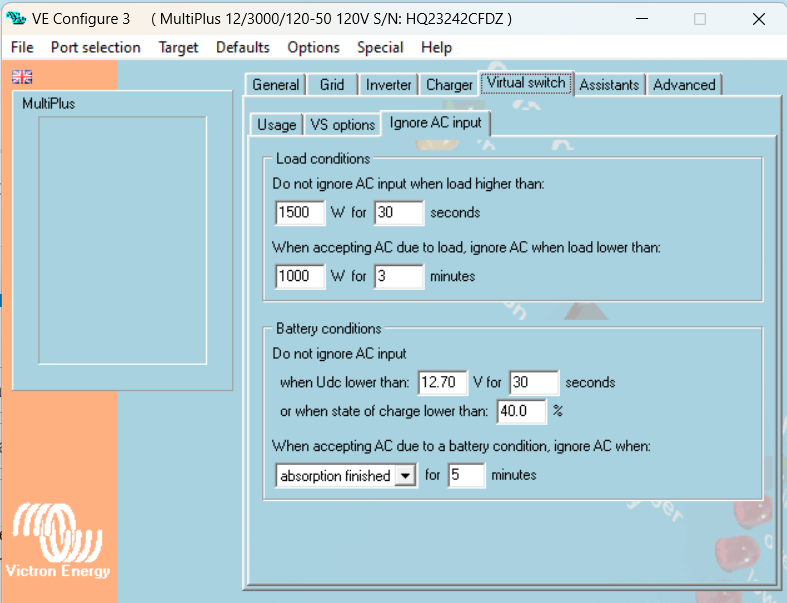

I have set up Solar and Wind so that my system runs as much as possible on Solar Power. I have also mimicked the settings in the Victron Suggested Article to have the Multiplus use the Virtual Switch to shut of grid power with the settings suggested in the Victron Article. It will not work and the Multiplus will not stop using grid even though conditions are met. Suggestions?
Virtual Switch article suggested in the Solar and Wind Setup from Victron https://panbo.com/maximizing-solar-production-with-victron-gx/
