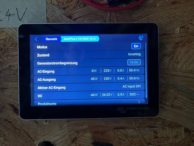

That is what the Cerbo GX is showing, while the generator is running:

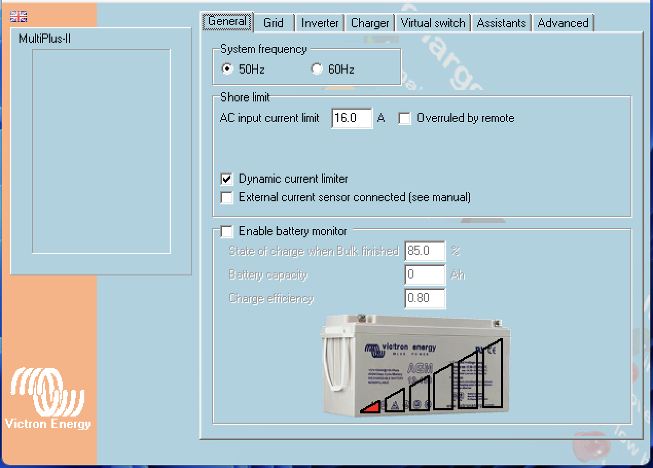

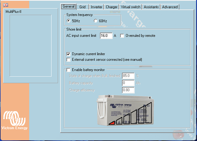

Here is my config:

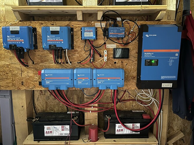

Here you can see the overall setup:
