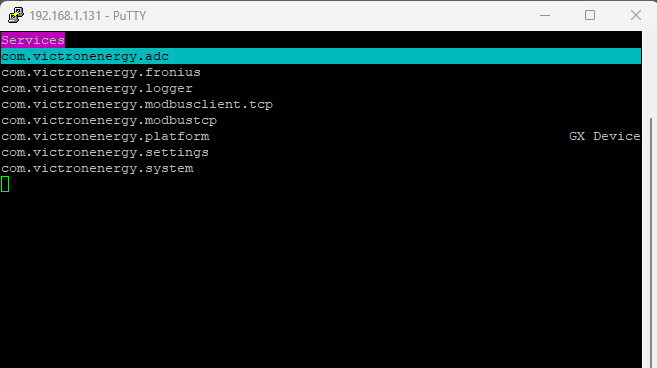

As in the menus I do not see the Multiplus neither VeBus I have done a VeBus rescan in VenusOS:
dbus-send --system /VeBus com.victronenergy.BusItem.Rescan
Running dbus-spy I cannot see a service for the VeBus:

I have now opened the case and checked the RJ45 cable connecting the GX board to the Multiplus.
The plug was not inserted correctly in the socket.
These solves my problem.
