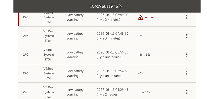

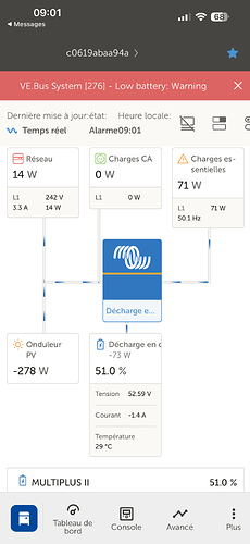

Everything works perfectly except when the battery is below 70% in the morning, from around 6 a.m. until 10:30 a.m. at the latest, during July–August 2026.
The message:
Instance 276
Device: VE-BUS System [276]
Description: “Low Battery Warning”, sometimes for a few seconds, then OK

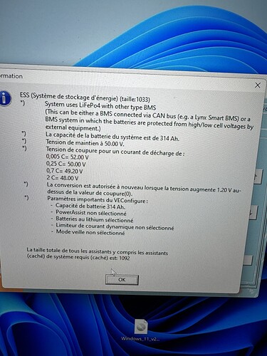

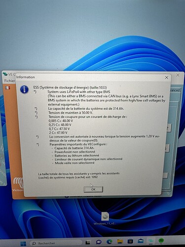

Bjorn Kellermann’s message put me on the right track, and I no longer have any alerts; the SOC is now triggered properly.
I didn’t dare try it at 46V :wink:
The ESS Assistant values needed to be changed.
Attached are screenshots of my values before and after the changes.
