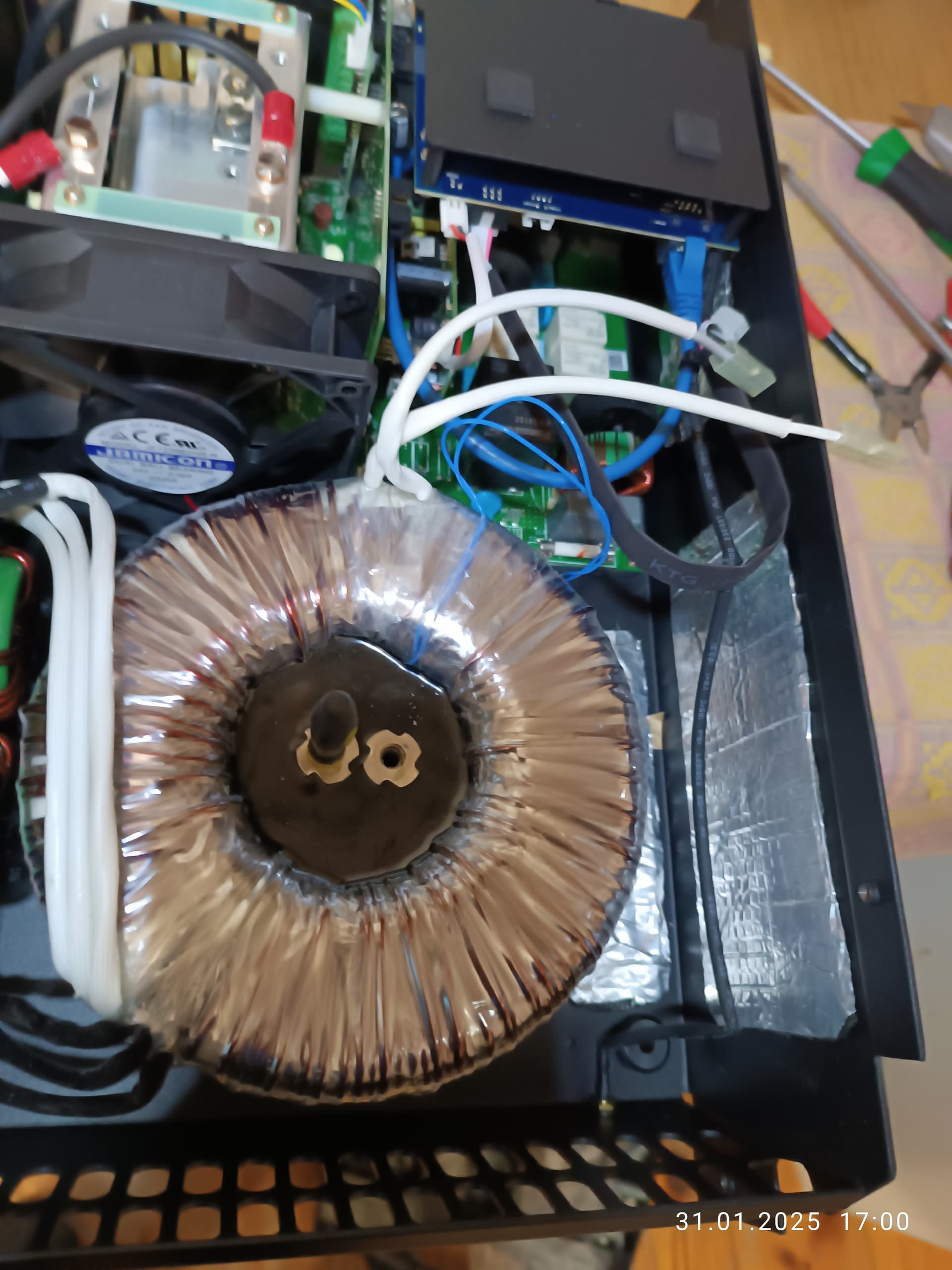

You could also place your multiplus on a rubber damping mat, with rubber plugs to decrease noise
A lot off users do that (me too), to avoid noise coupling from the wall
Add car vibro isolated plates 3mm at all surface where available, also under transformer and on wall mount. Also mounting and transformer bolts added rubber isolation. Really happy with result, it is not super quiet, but now I can leave with it. Don’t understand why Victron not makes it at fabric, is cheap an easy. Transformer is mounted at hard plastic circle stand, and it amplify transformer vibration to all case, and working like subwoofer. Happy, because really like VRM and settings ability in Multiplus.
