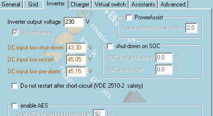

Victron DC input low shut-down = (2,7 * 16)+0,1 = 43,30
Victron DC input low restart = (2,8 * 16)+0,1+0,15 = 45,05
Victron DC input low pre-alarm = (2,8 * 16) +0,2+0,15 = 45,15

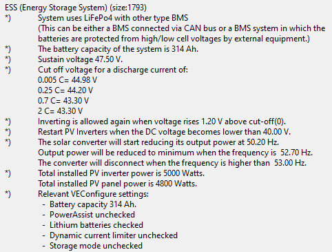

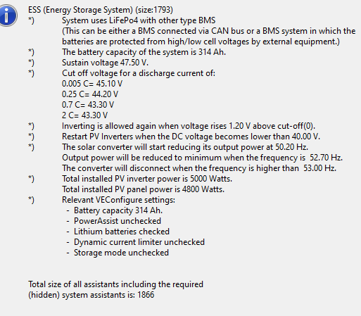

ESS assist.
Sustain voltage = 47,5
Dynamic cut-off 0.005C = 45,1 (your calculate correct)
Dynamic cut-off 0.25C = 44,2 (your calculate correct)
Dynamic cut-off 0.7C & 2C = 43,30

Are these measurements for these values measured by the Victron itself, or are they used as received from the BMS?
You should enter these settings into the configuration file “Bookmark Inverter” and the ESS assistant.
Yes I understand.
But I think cable loss should not be in the DC input low values, because the voltage will be lower and not higher when the maximum current flows (voltage drops, it doesn’t rise).
Or do I make a mistake here?
Make adjustments and enjoy, everything will be fine :wink:
UPD:
You measured your losses under load, they are within the specified values.
Your critical voltage is 43.45V
Victoron will work first.
Therefore, you have a wide range of battery capacity usage without harm or BMS shutdown.
:warning: Any changes in the BMS values: UVPR & UVP
Entails the change of all values ​​above!!!
I substracted the 0,15 cable loss from the lowest values, because afaik cable loss doesn’t add voltage.
Yes, towards the current.:+1:

I made a mistake, I used 45 instead of 44 volts (which is 16 × 2,75) for my calculation:
0,005C = 43,98V
0,25C = 43,10V
0,7C = 41,50V
2C = 36,86V
I will correct it accordingly:
Bookmark Inverter
ESS assist.
Dynamic cut-off 0.005C = 43,98 (your calculate correct)
Dynamic cut-off 0.25C = 43,3
