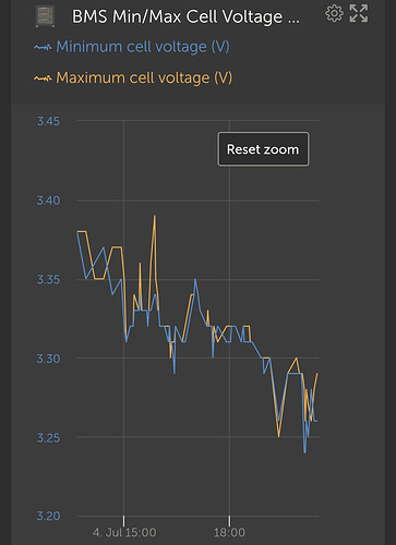

I have a new install that is having false low-battery alerts from the Multiplus2 with JK Inverter BMS, connected ve.can.
During that time I had a fully charged 24V battery (8 X MB31 with JK Inverter)
The VE Configure alarm values are set well below the Battery Voltage at that time.
These low battery alarms are false-positive, and coming from the Multiplus 2.
Can anyone suggest where I should look?

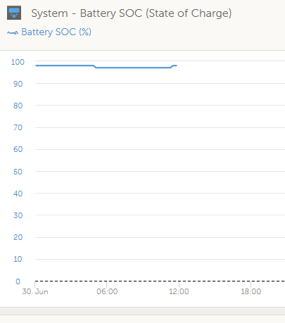

A few days later I have the issue that dess doesn’t charge to 100%, the absorbtion voltage is never reached. When I set the minium soc to 100% it does reach the absorption voltage and 100% soc.
This causes a soc drift and can cause a low battery alarm after a few weeks.
What’s wrong?

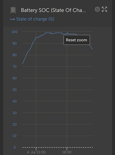

Okay, after disabling dess the battery is charged to 100% soc and stays in absorbtion mode long enough.
So it’s dess related.
Welcome to the DESS club :joy:
I noticed the same behavior since upgrading to v3.70~5. It seems that DESS changes the target SOC more frequently now. When the batteries are to be charged to 100%, the target SOC frequently changes between 99% and 100%. When it is at 99% around the end of the absorption phase, the battery may not reset to 100% and start another bulk phase. I already reduced the absorption time, but still had a few days where the battery could not reset the SOC to 100% before the discharging started in the evening.
