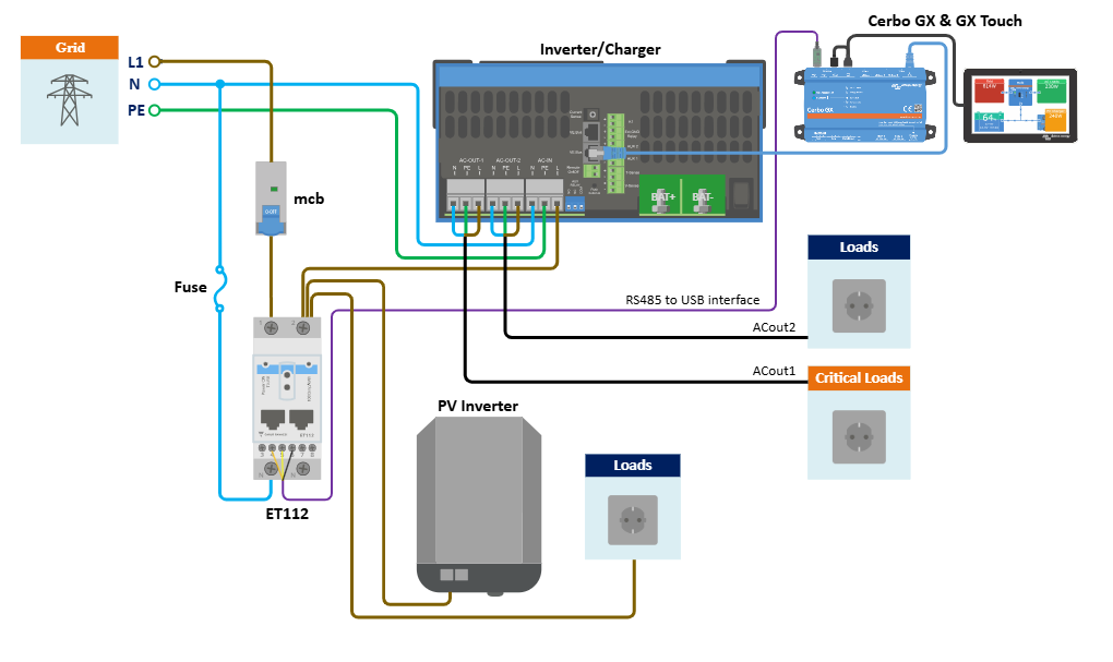

I have a system setup exactly like this.

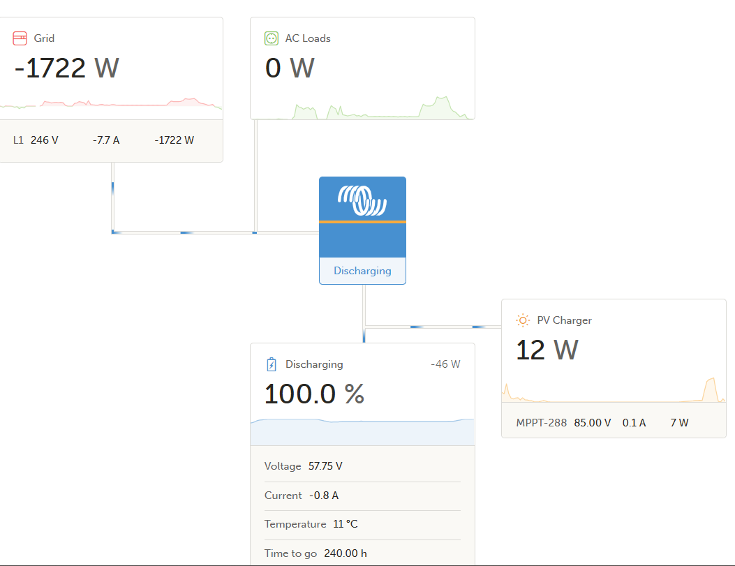

This is what it does during the day. (Which is right)
This is when it should be inverting to keep the grid @ ~50Watts.

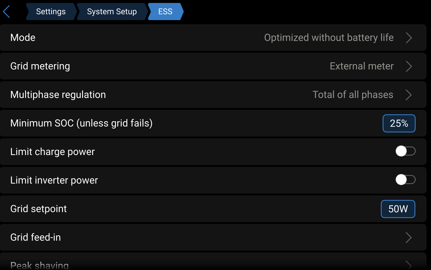

Without knowing all settings its a guess whats going on.

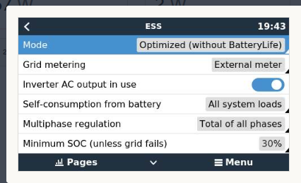

Funny enough I connected the CT back up to the inverter (so i have the external meter and CT connected to the inverter) and left the ESS Grid Metering set to External Meter and it started working. The only issue is the AC load on the AC in side is appearing as Critical Loads.

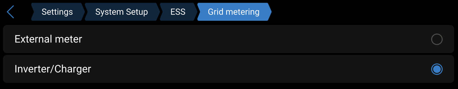

I have a very similar system. I use a CT on the grid and a “Victron Current Sensor” to measure the PV generation. Have you tried setting the Grid Metering option to Inverter/Charger instead of External? If you’re using the CT you normally use the Inverter/Charger setting. That said, if your unit has the newer connector block for the CT instead of the original jack plug, it might not make any difference.

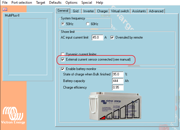

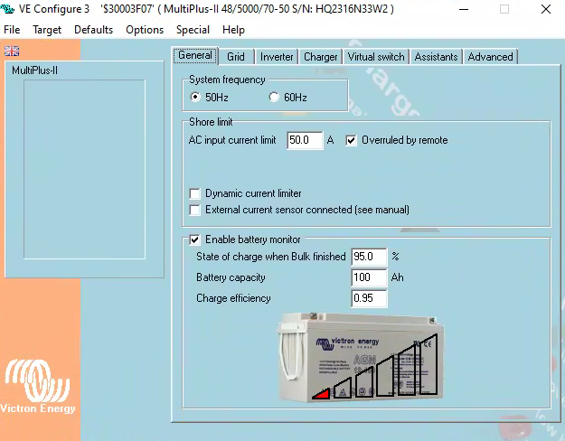

Have you set the inverter up correctly for when using a CT.
I don’t have that option ticked in my system when using a CT on the grid and it seems to work correctly.
