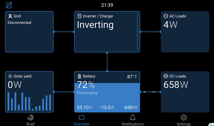

Hello,
I recently installed a MultiPlus-II 48V 3kVA unit to replace my trusty Sun Grid-Tie inverters :). Before this upgrade, I was running multiple Sun GT inverters on both legs of my system.
My setup:
  • 48V battery system
  • Victron Charge Controllers
  • Cerbo GX
  • Victron Shunt
  • Remaining Sun GT inverters still active on the other leg
  • CT sensor installed for the new Multi.
  • Multi connected to the grid via a 30A breaker on the AC-IN port
My goal:
I’m located in the U.S. and cannot export to the grid. I want to use the ESS function to import just 10–20W (even with full battery) and self-consume as much as possible from solar and battery. I fully expect to import power when needed, as I’ll never produce enough solar to be off-grid.
Issue:
The Multi is only inverting around 4W, and the system shows the grid as “Disconnected” in the GX system. My battery has plenty of capacity, so I expected it to be inverting more. I’ve set the Multi to “Inverter Only” mode. I’ve read a lot of documentation and forum posts, but I still can’t figure out what I’m missing.
In the GX screenshot, the DC Loads represent the Sun GT inverters operating on the other leg.
Can anyone help point me in the right direction?
Thanks in advance!

Ok, I think I found my problem, I changed the Multi setting from “Inverting” to “on” now, it’s properly displaying and inverting battery power to AC. I thought it should be “inverting” since, i don’t want to charge my batteries from the AC.
Another thing, even though I set the grid point 40W, it fluctuates to export a few watts from time to time, I might need to set it higher. Do i need to worry about the code ESS #6?
