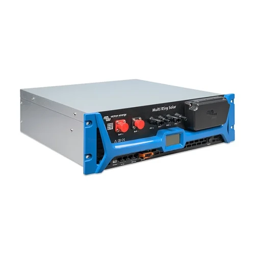

Multi RS19 Solar 48/6000/100-450/80
Hello
A quick question about the new product
which is starting to become available (for pre-order) in Germany
It specifies an MPPT voltage range of 64V–450V and a start-up voltage of 120V. It’s precisely this latter value that concerns me, as I’m currently at 80V and don’t want to move to 120V (minimum).
Do you have any information about the possibility of lowering the start-up voltage?
Because if it’s above 120V, in theory a permanent insulation monitor (CPI) is mandatory in France, unless the MPPTs have galvanic isolation, of course?
Thank you
The RS19 is a MultiRS unit in a 19-inch rack. It therefore has both an insulation monitoring device (IMD) and galvanic isolation between the DC bus and the battery.
I get the impression that he’s talking about the Multi RS Solar 6kVA.
In “Multi RS19 Solar 48/6000/100-450/80”, apart from the 19 and the 80, the rest matches the specifications of the Multi RS Solar. Moreover, the description he gives corresponds to this product, not the new HS19. The Multi RS Solar is nothing new. It’s already been on sale for some time.
@Joe, could you clarify which product you’re talking about?
If its like an rs450/100 then it will need 120V to start the tracker but then just need to maintain a minimum of 65V from there.
Don’t confuse RS19 and HS19: they’re two new products, but they’re very different products!
OK. Has there already been an official announcement about the RS19? I haven’t seen anything in the News.
The specifications are virtually identical to those of the Multi RS Solar, apart from the form factor and battery connection.
I am indeed referring to the new 19-inch rack-mounted model.
Thank you for the information about the CPI, as well as the galvanic isolation.

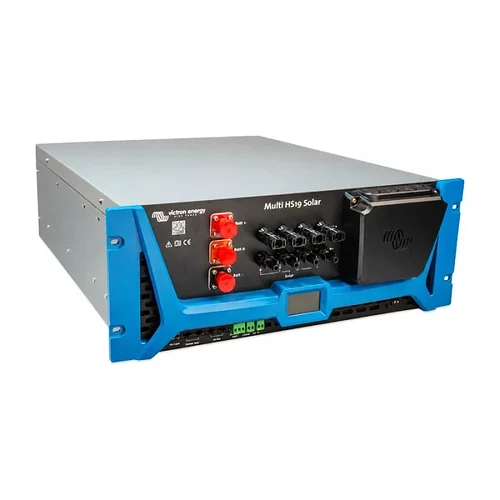

I am comparing the new Multi RS19 and Multi HS19 for an east-west PV system with 25 AIKO 485 W modules.
AIKO 485 W:
  • Vmp: 34.3 V
  • Voc: 40.9 V
  • Imp: 14.15 A
  • Isc: 14.88 A
The RS19 supports 16 A Isc but only 12 A operating current and 450 V PV voltage.
The HS19 supports 600 V, which is ideal for 12/13 module strings, but the datasheet specifies only 13.5 A MPPT current and 13.5 A short-circuit current.
Is the HS19 officially compatible with these AIKO modules, or are the current limits a hard restriction?
Which inverter would Victron recommend for this application?
Use the ‘Victron Mppt Calculator’
With 25 large panels, you could end with the Smart Solar RS 450/200 (48volt) battery charger and a 48 volt inverter of your choice.
Thank you. Unfortunately, the MPPT Calculator does not include the new Multi HS19 Solar yet.
My question is specifically about the HS19 hardware limits.
The AIKO 485 W modules have an Imp of 14.15 A and an Isc of 14.88 A.
The HS19 datasheet specifies 13.5 A MPPT operating current and 13.5 A short-circuit current.
Does Victron officially approve these modules for use with the HS19, or are these current limits strict hardware limits that make these modules unsuitable?
If its anything like the mppt design in the rs450/100 its a soft limit and the rs450 manual specifically talks about edge cases where you may want to exceed that:
16A operational limit
20A reverse polarity limit
30A short circuit limit (in correct polarity).
Fundamentally assuming you have a 350V string for example the 4kW per tracker limit would limit you to around 11.5A real world anyway, even if you had two parallel strings on the tracker.
Thanks. That makes sense for the operating current.
However, my main concern is the 13.5 A short-circuit current specification of the HS19.
My AIKO modules have 14.88 A Isc, which is above the datasheet value.
Can anyone from Victron confirm whether this is an absolute hardware limit or simply the recommended design limit?
You know the hs19 is for high voltage batteries only? 650-1000Volt DC, wich required special switches, fuses, cables, DC connectors, many safety requirements, special battery room…there are not many low voltage DC ESS installers who dare their hands on high voltage ESS systems.
High Voltage ESS systems are for large scale systems with huge battery capacity and over 100 solarpanels, not for the smaller home system.
That’s exactly what I’m wondering: whether we might exceed the ISC threshold, even by a tiny amount.
