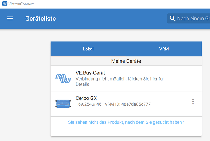

As far as I understand, VictronConnect is the next prefered method to update FW and VE_Flash is no more supported. VictronConntect shows unexpected errors if I try to connect the daisy chain by MK3 probably because of FW incompability. Connecting to a single MP2 device is succesfull.

  2. Cannot find the Multiplus. This is the case, if versions in a RS485 chain do not match before flashing.
The problem seems recursive. Arrays cannot be configured because of diffrent versions and version update cannot be performed because of unrecognized array configuration. To solve this chicken - egg problem, thei only way was to connect the MK3 cable 1:1 each device individually.
