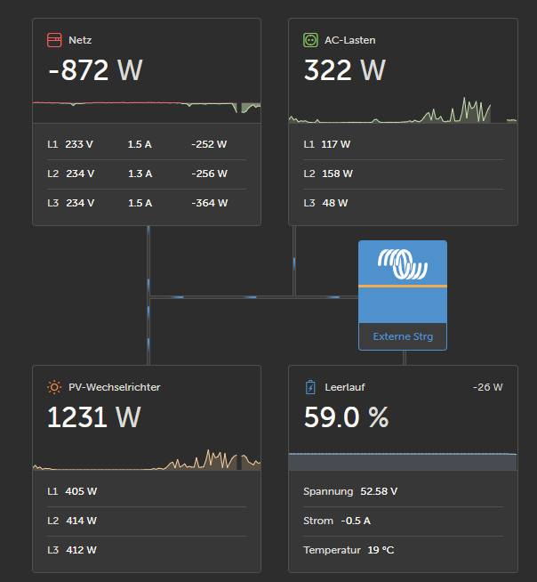

this is my third system, however major difference the first two run on Pylontech, this one here on Pytes V5a. The system is up and running, however the battery is not charging (but discharging)
Setup:
MPII 48/5000
Cerbo GX MK2 Venus large 3.62
EM24 Ethernet
Solaredge PV (modbus tcp)

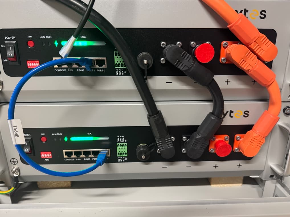

2x Pytes V5a

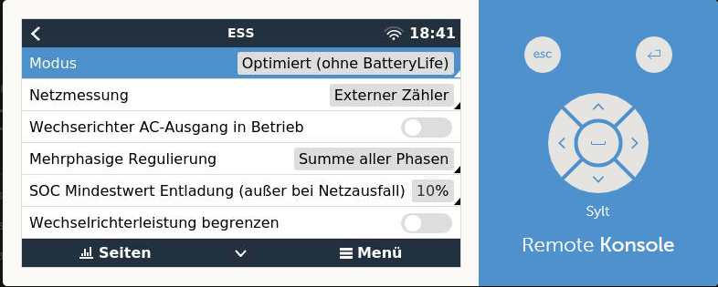

Setup of ESS and settings done according to this guide:
System in VRM looks

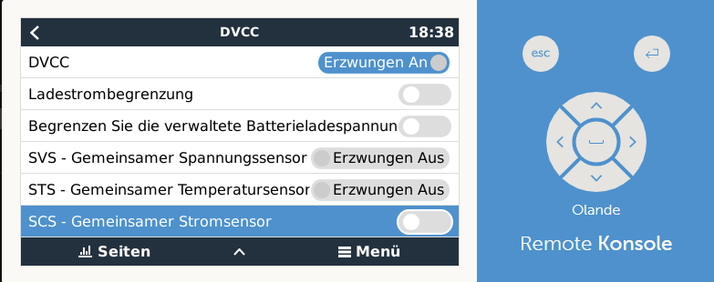

Settings in Remote Console:

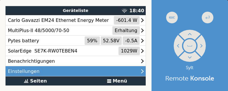

I am a bit unsure where to look now. I do see the battery in the menu, I do see the voltage. Funnyly it discharges, but does not charge.
