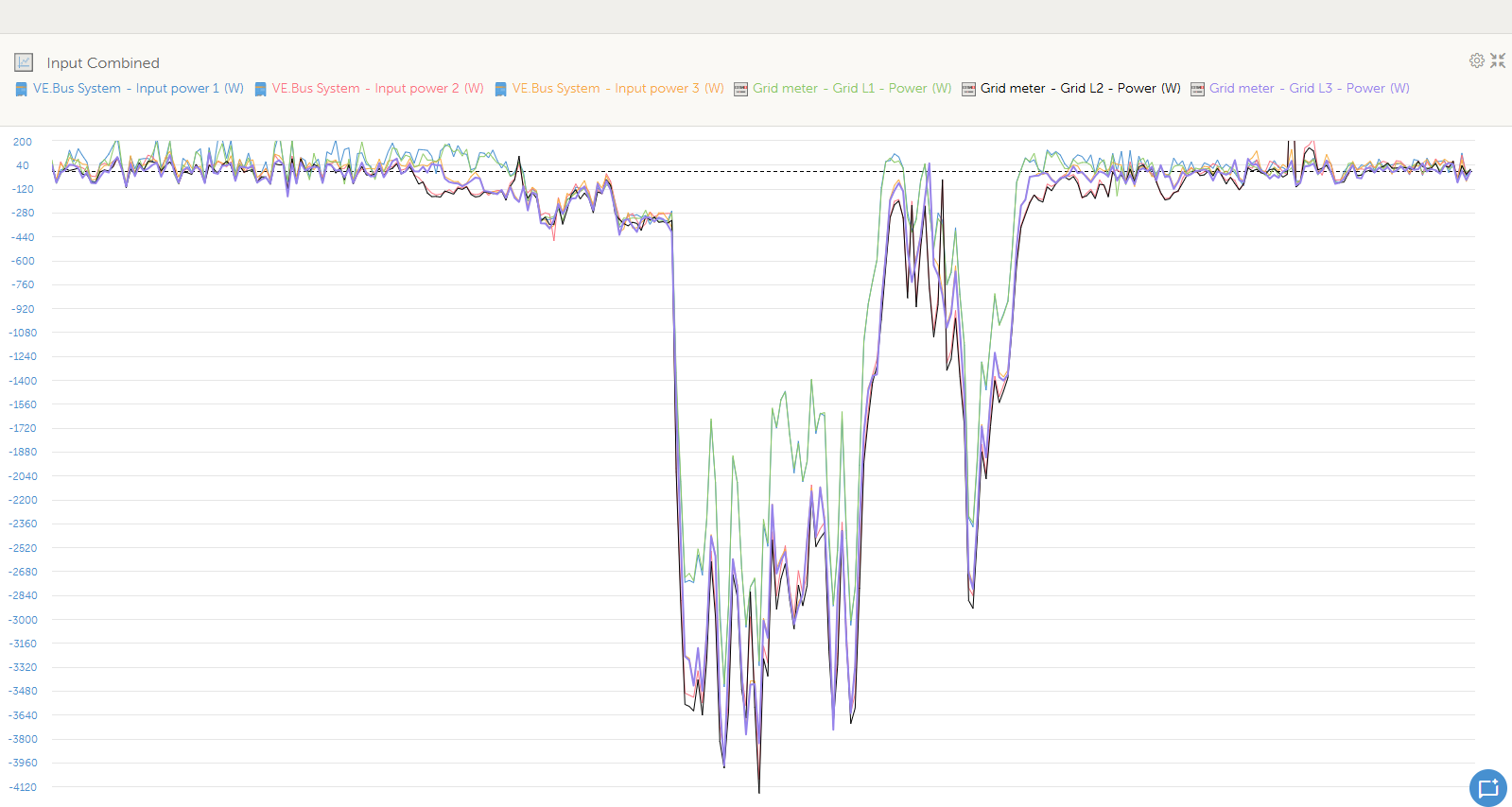

My graphs look like this - and yep, I have GridSetPoint at -150W, which definitely does not look so when looking at the graph:

Is this graph now the values reported by the multiplus for ACIN, or the values reported by the meter?
Maybe you wanna create a graph showing both (:= All 6) values, eventually there is difference visible?
Something like
It seems meters of VE.bus and grid meter are in accordance. This is with the GridSetPoint of -60W, still this is the result - taking around 0.4 to 0.6 kWh thoroughout the night from the grid!

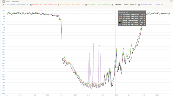

I have step-by-step tried getting the GridSetPoint as low as -250W. However, the only difference with GSP of -250W was that I still took around 0.8 to 1 kWh thoroughout the night but sent also another 1kWh to the grid… So meaningless for me this way!
This seems to be the diagram when GSP was set to -250W.
Whereas this is the “best” result ever - from 0:00 to 6:00 I got from the grid mere 0.1 kWh which is reflected on the graph. But dont know why - GSP was -60W, consumption in the home fairly low (but different days with same consumption end with 0.4kWh from the grid!

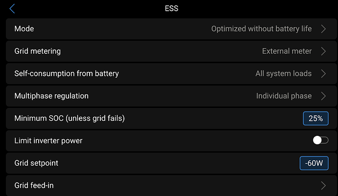

I believe I have individual mode set on - as I see here. Still I get these amounts of energy from grid every night:
