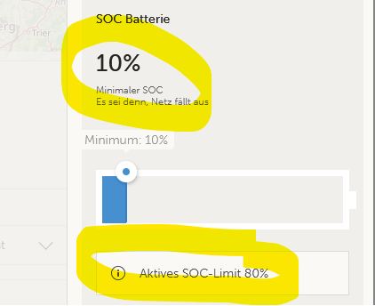

You can check the SOC limit set by Battery Life in VRM at the top right under the hamburger menu.
For me, it’s currently set to 80%, discharge up to 10% is allowed
What happens if you switch to without battery life?
