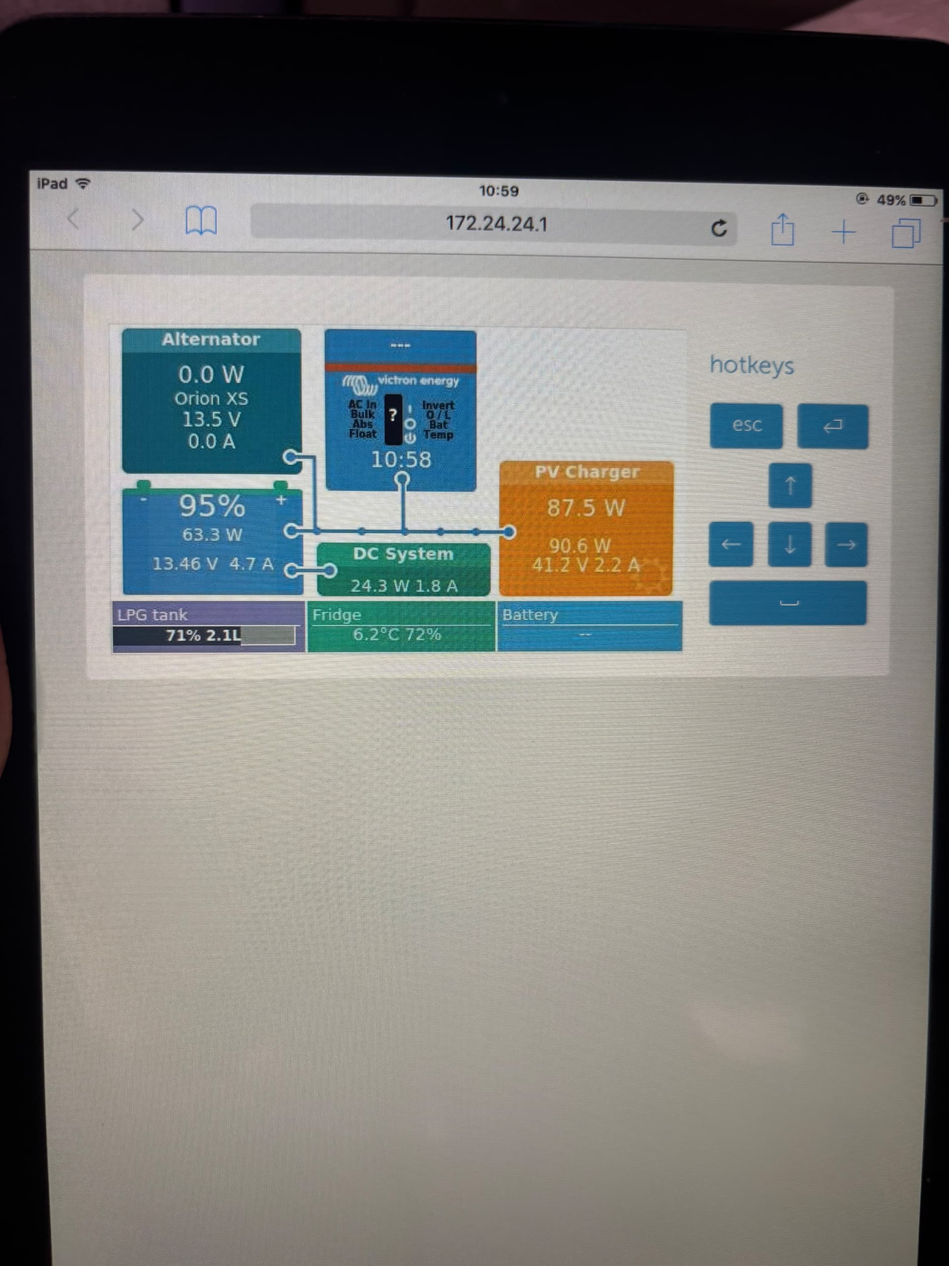

When I switch my inverter on or off via the gerbo s gx interface my temperature sensor gives some weird values and disappears. I have added an image.
Is this common? Can I fix this issue?
The only thing I changed recently is switching on DVCC. But when I switch this off again, the temp sensor keeps doing weird stuff.

Yes it is the sensor of the inverter yes. But sometimes it also stays on. So it is a bit weird. Also the status of the multiplus in the gerbo gx becomes sometimes unknown for the gerbo. While if the status stays on ‘off’ then the temperature sensor keeps working correctly.
It’s more likely just a timing issue.
If the inverter is off the sensor won’t be available.
