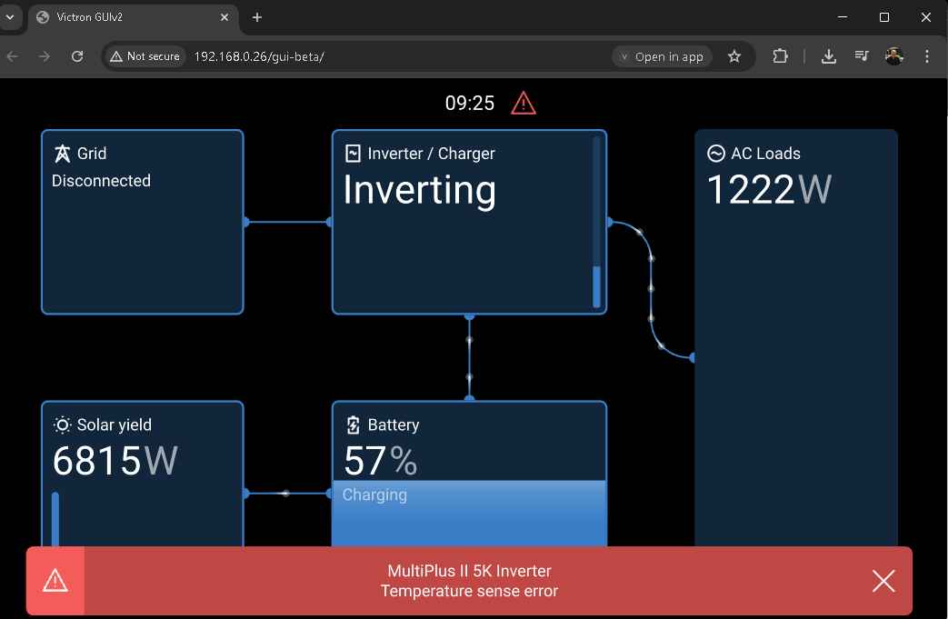

Does anyone know what this Temperature sense error is?
How do I fix the error?

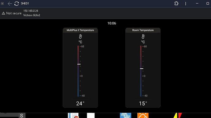

Faulty sensor. OV
All good now.
Thank you
Measure the multi T sense input with sensor disconnected.
Voltage should read ~5v. (??)
Now working
