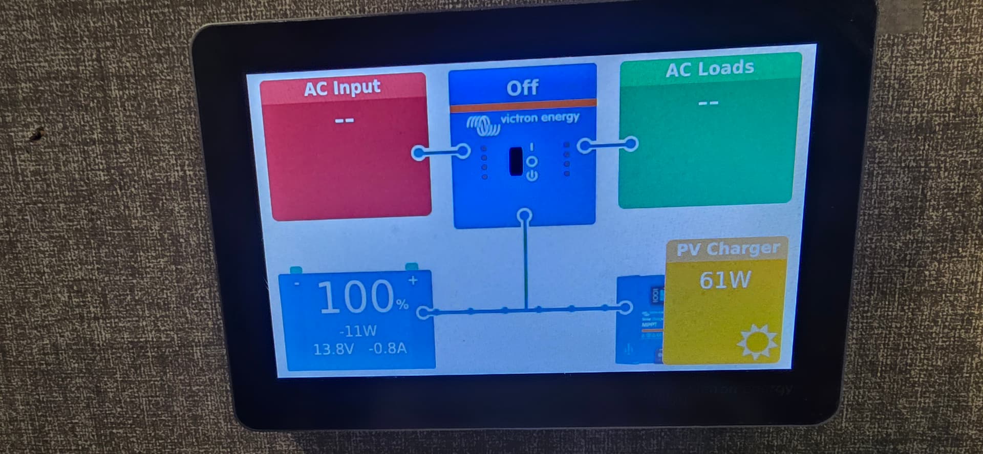

Cerbo GX not displaying AC In/Out and status of Inverter
For about 4 months my Cerbo GX has not been showing AC In/Out and status of Inverter on the connected display. Very similar to this archived post.
I bought another Cerbo GX since this is what fixed this individuals problem. After swapping out Cerbo GX the symptoms were the same.
Lower pages in the Cerbo gx show the correct status and information.
Multiplus 12/3000/120-50. Firmware 556
SmartSolar MPPT VE.Can 150/100 rev2 Firmware v3.16
BMV-712 Firmware v4.16
Solved! Ve.Bus to USB stopped working properly. Connected rj45 direct and it is displaying properly now.
