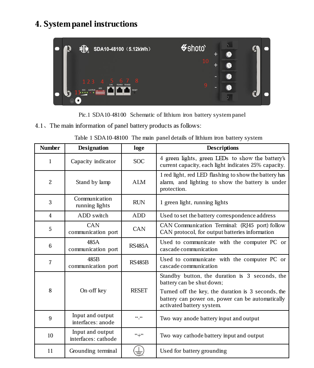

I’m in Africa with limited battery options. Can I make the Multiplus 5000 work with the Shoto sda10_48100 batteries?
looks like it uses the same BMS as the Pylontech battery, so would probably work similarly, but no guarantee.
Thank you Mike. Where can you see that it uses the same BMS as Pylontech?
Looking at the front panel of the battery, the BMS card layout looks identical.
Pylontech buy in a 3rd party board, so that is also available to other battery producers.
