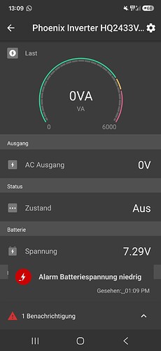

The voltage displayed can’t be correct. Even on startup, the full battery voltage is present.
The remote control has been disconnected and a reset performed.
At the moment, it’s showing a solid 7 volts…
