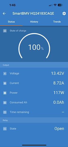

Installed 712 Battery shunt now screen says "Deep Discharge"
Can someone tell me what is up? Just installed the shunt and got the settings set via phone. Although I have not synced because I’m not full yet. 3 Lithium batteries are Charging via Solar as usual and were close to full already. The RV is plugged in today to use the Air C. but the Solar is still pumping . Note the app does not show this error only the remote screen does when pressing Select.
You have got it on the history screen, see the little text history below Deepest, and it will record the deepest discharge ever. If you go to the history tab on the app it will do the same. The app has a button to reset history, you may want to do that once charged to 100% for the first time.

Awesome, thank you. That means all is good.

Yes, it is not an error message.
