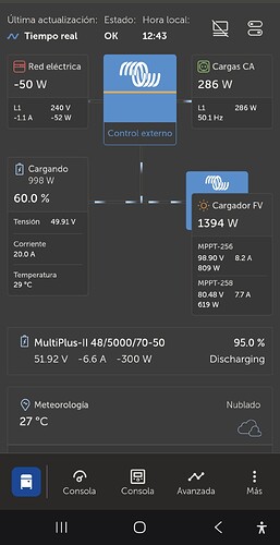

Hello, I have a system consisting of a Multiplus II 48/5000/70-50 inverter, a 250/100 MPPT and another 150/100, a Color Control GX and two Pylontech US5000 batteries. The issue is that, for the past few days, it has started exporting to the grid before the battery reaches 95%, as it used to do until now.
I’ve noticed that the battery’s BMS says 60%, while the Multiplus shows a reading of 95%, switches to absorption and exports to the grid. This happens when it reads 51.90 volts.
Could it be related to what appears on the DVCC screen? What solution can we find for this?
The multiplus is seeing the 51.92 that you have the voltage capped at.
The battery voltage is much lower at 49.9
So yes probably.
What is probably the issue is soc drift from the voltage cap and never charging to full.
Give them a good charge or move the cap up to 52.4v

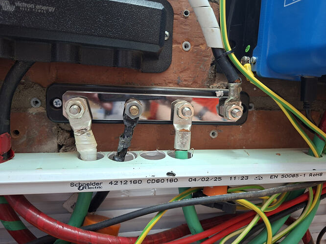

If you have an IR/remote temperature measurement drive or IR camera, charge/discharge to grid (ESS grid set point) or use other ways to generate load on DC cables and battery. Then measure temperature on all contacts with the remote temperature measurement device.
Well, I think you’re right, as I found this while investigating. The middle cable is burnt, and it’s the negative one that goes to the battery. I’m going to replace it with a new one. Thanks for your help
Great you found the issue.
Please substitute the DC bus bar by a Victron Lynx Distributor with fuses sized for your cables.
With some additional hardware and some free software, you get alarms in Venus OS und VRM if a fuse is blown.
See my system thread linked in my profile, which includes all items needed.
