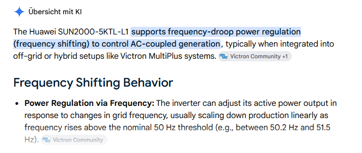

Because frequency shifting is defined in 4105, just like NA protection.
It would also have been very easy to find with Google.
Yes, that’s what Google says, but since it has 5 kW, it doesn’t comply with 4105 and isn’t approved for use in Germany! That’s why I’m asking the group whether it works in an off-grid system.
