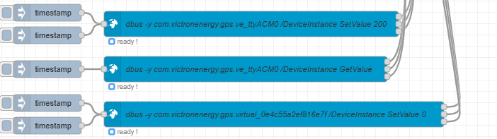

Feel free to snoop around my in my Node-RED flow. I left traces of past attempts to get this sorted.
It is all about the boat page for us,… :motor_boat:
As noted above, local console boat page uses USB GPS, remote console boat page uses virtual GPS.
Happy for you to look at mine as it has both USB and virtual GPS. I am sure you have been on it before.
I bypassed that specific priority issue by removing the gps-dbus.ttyACM0 service altogether and processing the incoming GPS NMEA datastream from serial port to virtual GPS in Node-RED. This works as a charm until the next (remote) reboot or firmware update required manual disconnect and re-insertion of the gps.

        "name": "dbus -y com.victronenergy.gps.ve_ttyACM0 /DeviceInstance SetValue 200",
        "commandLine": "dbus -y com.victronenergy.gps.ve_ttyACM0 /DeviceInstance SetValue 200",
        "commandArgs": "",
        "minError": 1,
        "minWarning": 1,
        "noStdin": false,
        "format": "",
        "payloadIsArg": false,
        "myssh": "53238a8e0e43bae0",
        "x": 480,
        "y": 2160,
        "wires": [
                "24c2e1377d5e19c4"
                "4c95bf80781e4cf4"
                "0c9824c09e7d8f59"

        "id": "ea0dea956f8170b5",
        "type": "bigssh",
        "z": "8fb5afb2b0b585a3",
        "g": "54f673c06c921b89",
        "name": "dbus -y com.victronenergy.gps.ve_ttyACM0 /DeviceInstance GetValue",
        "commandLine": "dbus -y com.victronenergy.gps.ve_ttyACM0 /DeviceInstance GetValue",
        "commandArgs": "",
        "minError": 1,
        "minWarning": 1,
        "noStdin": false,
        "format": "",
        "x": 470,
        "y": 2240,
        "wires": [
                "24c2e1377d5e19c4"
                "4c95bf80781e4cf4"
                "0c9824c09e7d8f59"

        "id": "73a3431641cc0294",
        "type": "bigssh",
        "name": "dbus -y com.victronenergy.gps.virtual_0e4c55a2ef816e7f /DeviceInstance SetValue 0",
        "commandLine": "dbus -y com.victronenergy.gps.virtual_0e4c55a2ef816e7f /DeviceInstance SetValue 0",
        "commandArgs": "",
        "minError": 1,
        "minWarning": 1,
        "noStdin": true,
        "format": "",
        "x": 520,
        "y": 2320,
        "wires": [
                "24c2e1377d5e19c4"
                "4c95bf80781e4cf4"
                "0c9824c09e7d8f59"

I have been down that route and indeed managed to set custom device instances. But that didn’t result in a switchover of the systemwide priority GPS datastream as far as I can recall..
thanks both. I logged into pwfarnell his system and got what I wanted, a brief check on how the data that I was looking for looks:
‘GpsService’: ‘com.victronenergy.gps.ve_ttyUSB0’,
‘GpsSpeed’: 0.0,
By the way, @pwfarnell , below is a copy of our virtual GPS. Note how the fix path is empty. For this system wide selection mechanism to work, you need to set Fix to numeric 1.
Leaving it set to INVALID, which is what that empty array, [] is, doesn’t work.
root@einstein:~# dbus -y com.victronenergy.gps.virtual_33b273864e49d3a7 / GetValue
value = {'Altitude': [],
 'Connected': 1,
 'Course': [],
 'CustomName': 'Dummy gps',
 'DeviceInstance': 100,
 'Fix': [],

And, make sure to set the device instance of that GPS lower than the USB-connected one. To change the USB connected one, use the Settings → VRM → VRM device instances menu.
Then everything on your side is done correctly.
But after that I expect all of it to still not work correctly on the boat page, as that is is most likely broken and we’ll be looking into that.

Thank you Matthijs. Set Fix to 1, set USB GPS to a higher instance, I will report how boat page works tomorrow.

I’m quite sure that you can’t set a device instance that way.
For tailscale, see: GitHub - kwindrem/TailscaleGX: tailscale for Victron Energy GX devices
Thanks, I’ll revisit the ‘device instance’ driving ‘global priority’ route with the next f/w update. For Tailscale we are waiting for our Starlink router to arrive.
Virtual GPS instance 100, USB GPS instance 101, both local and remote consoles now use the USB GPS. Consistent but not what was wanted.
