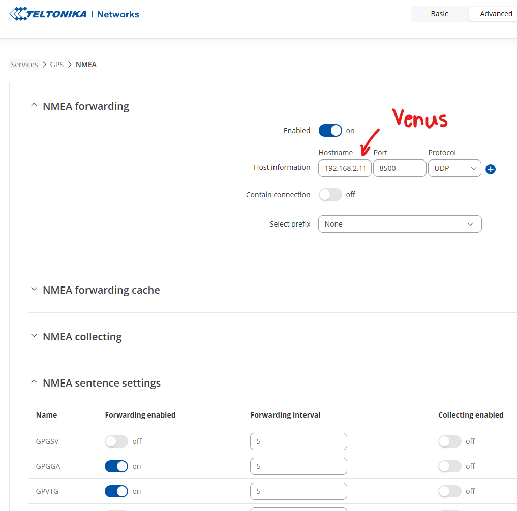

This is working in Node-RED for me. I had the socat system (that you linked to) working but something broke either at the Venus end or the router end. I couldn’t figure it out.
I now just have the router forward the NMEA data to the Cerbo on port 8500. All the NMEA sentences are disabled apart from GPGGA and GPVTG.
Please note: It does require you to install the node-red-contrib-nmea Node-RED module.
Virtual GPS - RUT955.zip (1.4 KB)
