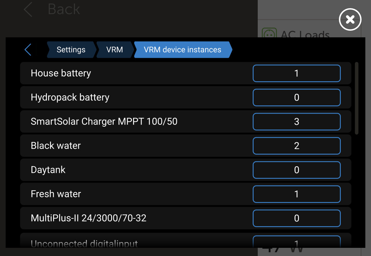

You can change the VRM Portal instances, which is the same number as used for the Modbus-TCP server Unit IDs in the Settings → VRM → VRM device instances menu:
Thx :+1:t2: this change will also change the Unit ID as well :hugs: now all devices are separat at HA.
