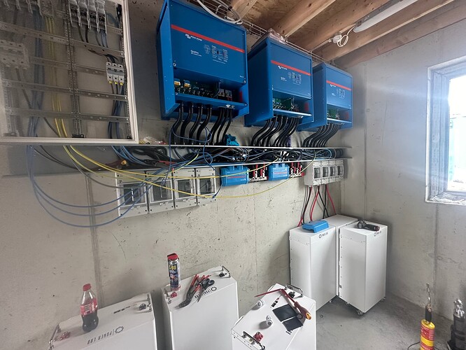

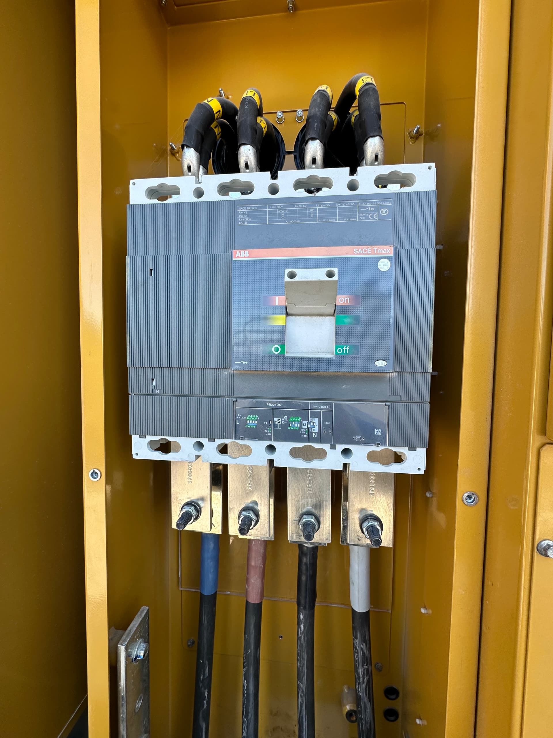

Hello . I’ve installation that runs of 550kVA cat generator powering up concrete mixing plant and gravel crushing gear . There is 45kVA ESS setup on this to charge battery and keep stuff online when generator is off at night and in between cycles . :repeat_button: however I would like to measure consumption from the generator to the heavy machinery with meter . I can’t send entire load via Quattro as amps are very hi and wouldn’t be able to do with 3 x 15 kVA . I need ac load side meter with clamps :clamp:. Can I use any meter to be set to run @ 500A plus ? Large ct and adjust ratios ?

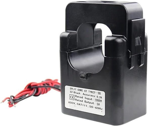

Requires Current Transformers. You could use 1000A/5A split core CTs with it.
Yes any CT with 5A secondary can be programmed to work. You have to enter CT rate.in meter setup. Primary/Secondary. For 1000A CTs a value of 200 would be entered (1000/5)

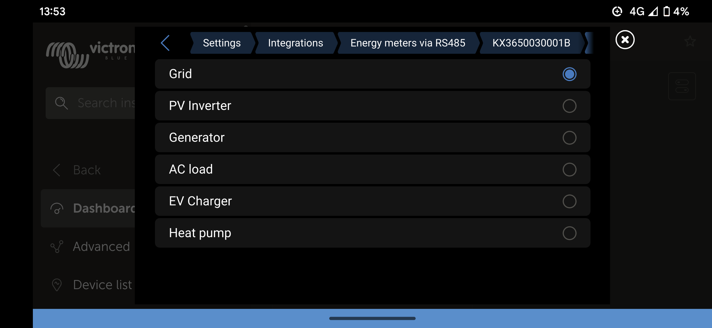

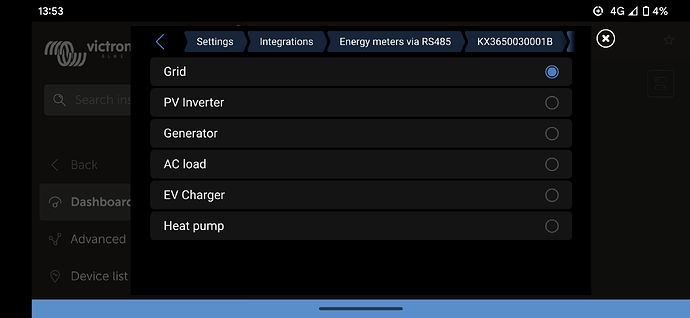

I seen in setup meter role can be set as ‘AC Loads’

Finding 1000A/5A split-core CTs that are big enough for your cables could be a challenge.
In the US, I found these on Amazon.
To date biggest configuration I’ve done is 400/5A rate with the EM530s however shouldn’t be a problem going bigger.

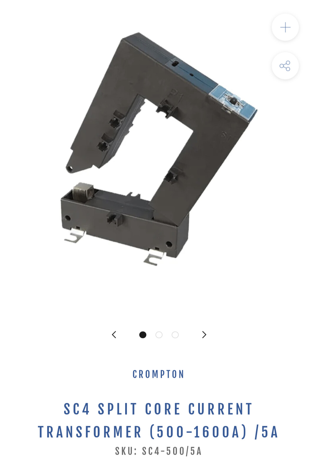

Have got large frame ones like below before. Handy if there’s parallel cables.

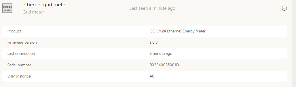

I use the ethernet Carlo Gavacci meter EM24 with 1000A CT’s as gridmeter
Measuring everyday into 700A and sometimes into 900A while voltage very stable.
I prefer ethernet as during last 15 years of RS485 I had more troubles with those interfaces going bad than the ethernet versions. I still use both but have not bought RS485 anymore recently.

It seems to have problem with cerbo at the generator role … anyone anything? Meter role as generator and heat pump aren’t working right . Grid seems to be ok and pv inverter seems to be ok , haven’t tried ev yet … definitely GENERATOR ROLE IS IN TROUBLE.
It’s working but not registering can’t create graph in advanced , no data register. Yet meter itself running .
Hi there is a trouble with generator role :slight_smile: not registering
