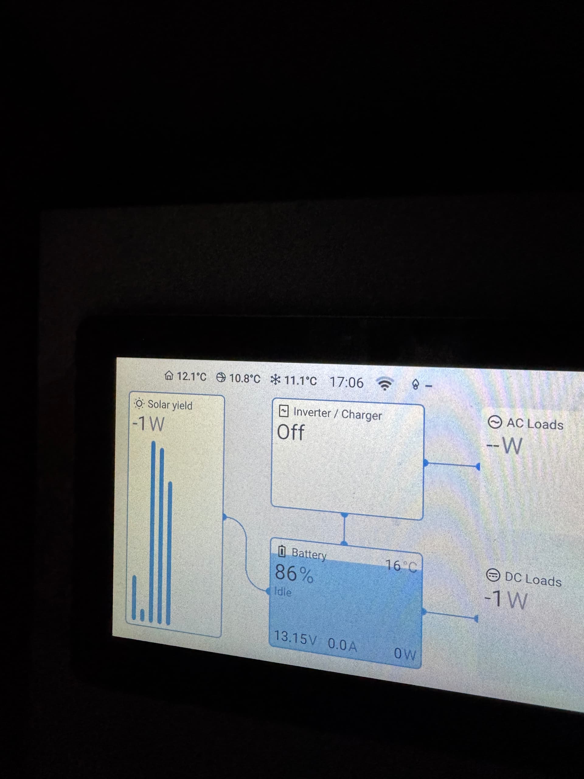

Help with installing GUIv2 mods 3.70
Can anyone help please I have written my mod to get my temp sensor and water on my overview page but if I update to the beta and reinstate it it doesn’t display at all
Any advise
Attached is my script and result

Sorted it it was dubs serial battery overlay that’s all
