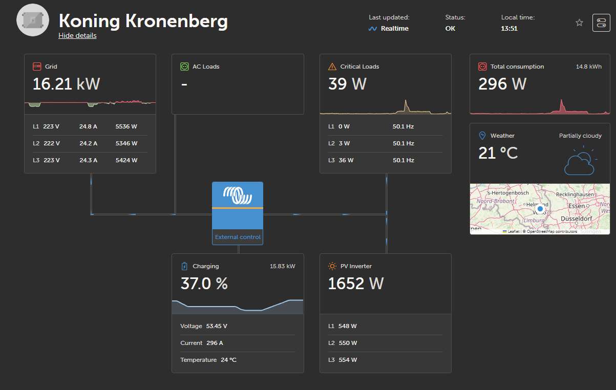

I have 6 Multiplus 2 in 3 phase configuration and a 27.6 kW Solaredge inverter.
I changed the solaredge inverter from AC in to AC out. (I updated therefore the ESS assistent with VE configure)
On VRM the SE inverter is correct showed at the AC-out however on the GUI the SE inverter is atill showed at the AC-in (see pictures)
Is this a bug in the Victron SW ( I have SW version 3.64) or do I miss a setting?
This is intended behaviour for the new UI. AC sources on the left.
That’s normal.
Thanks for the feedback
