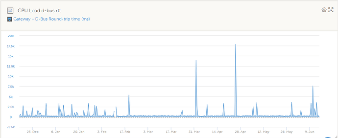

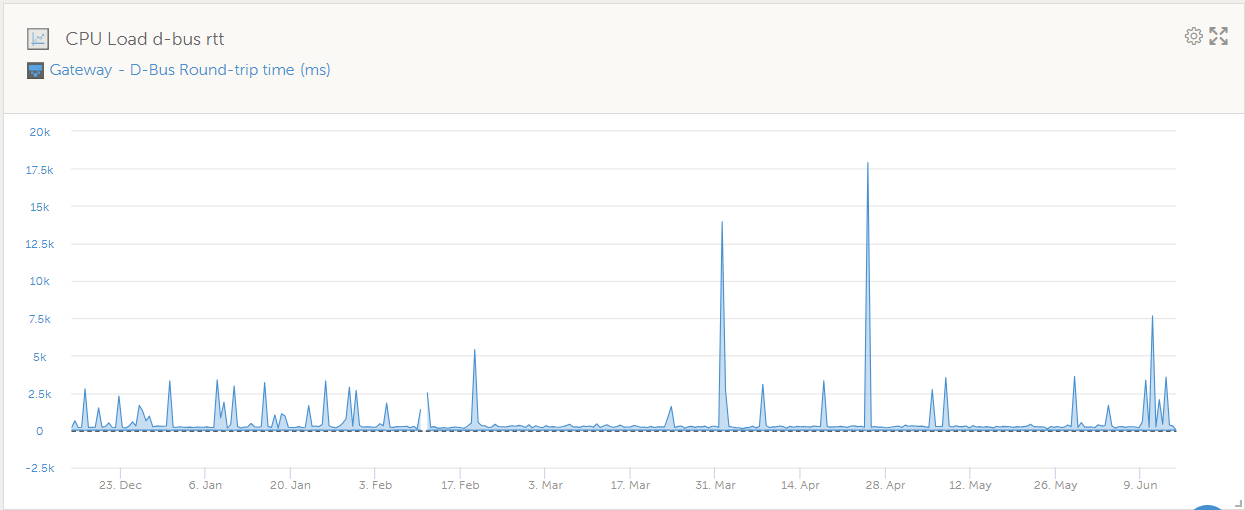

  • I checked the CPU load on VRM, up to 6 months back. And it has always been on the edge, sometimes over the edge. For example on Feb. 12th this year, also Error code #67 No BMS.
  • The CCGX is rebooting because its out of memory; And the same thing has been happening in the past as well. April 25th, May 6th, May 29th. and more dates.
  • Here is a graph of dbus round trip time, the base level is 60 to 200ms, already high.
  • That CCGX has been at or over its limits as far as I can see in the past using VRM, and still is today while running v3.55.
  • For a 100% stable system, the recommendation remains to update that hardware. Sorry. We might find an improvement or solution in the coming weeks - but similarly also might not.
