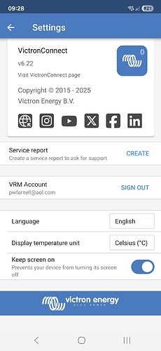

I know this is not a solution, but it may be useful if anyone sees this befire they do firmware updates.
On VictronConnect app settings you can choose to keep the screen on, so it does not go to lock screen, suggest you do this.

  • select each device and update firmware as needed (note the radio button in the VictronConnect app to keep your screen from locking out)
