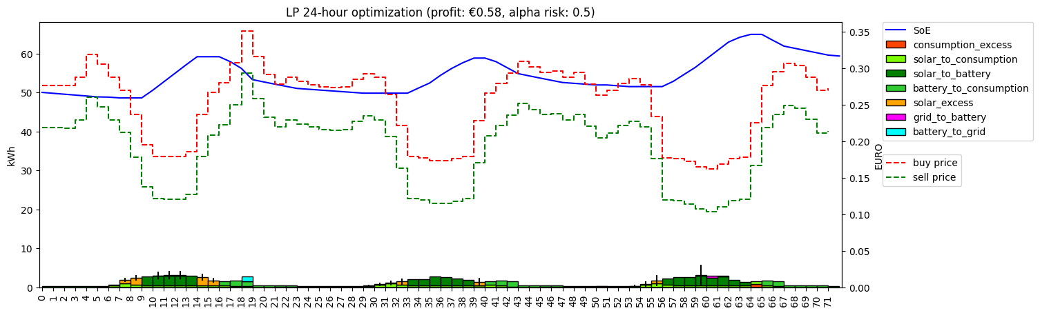

Thanks @bartm for highlighting the issue of large batteries draining over time. Turns out my assumption was wrong. A longer forecasting window will cause the battery to drain, only at a slower rate. This is unwanted behavior:

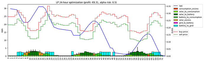

I overhauled the battery state of energy logic to be able to modify the objective function. The solver is now reimbursed for the energy that it has at the end. But I have found this behavior to be very difficult to steer using a min function or quantile(buy_price, 20%).
For this case a quantile(buy_price, 30%) + cycle_cost works:
But I imagine the current implementation of a quantile is very depended, on the number of cheap and expensive hours. What does seem to work is median(buy_price) * inverter_efficiency + cycle_cost, It captures the true replenishment cost, but I do not know how well it works in edge cases. For now I leave it, but maybe in the future a min SoE is needed to have the battery stay in a certain region for large systems.
Hi @nortciv. Nice simulations! Setting the terminal energy valuation to the minimum should have only an effect if there is excess solar. It will never buy energy from the grid to store in the battery because it’s not worth is (taking into account efficiency). If you increase it, the optimization should buy from grid at times where the buy price is lower than the chosen value.
During winter, when the risk of having a full battery due to large solar production is small, you could even argue that a fixed price makes sense: This should translate into “if the price is below x, buy from grid to use at a later time” behaviour. (note: in Belgium there are a lot of taxes, so a huge gap between buy and sell price. In practice thes means that there are almost no trading opportunities).

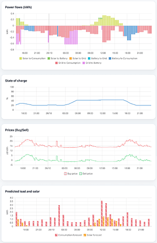

I’ve pushed an update that allows you to enter a token and fetch data from the VRM API (Everything is handled client side so your token is safe. There is only communication between your browser and Victron.) If you have DESS configured, it can autofill some settings and it also fetches forecasts and prices. The graphs were updated to work with actual times instead of generic time slots.
note: the victron forecast data is still hour-based. I split them over 4 equal15-minute intervals. For the PV data, it might make sense to do a smarter split.
The generated plan almost perfectly matches what I see in DESS, so it’s a good starting point for making tweaks to the rules if I/we spot situations where we think DESS should behave differently.

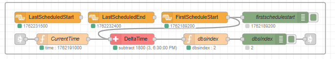

First by reading and filtering for change (up to 8 times per hour, all nodes set to “on change”)
And then use that “change” signal to immediately push any modified SoC / Strategy values to the correct register (for current timeslot, see dbsindex) to be picked up by the DESS execution process. And therefore have the modified values instantly forwarded to the “Set Target SoC% for this timeslot” and “Used Strategy for current time slot” that drive the inverter.
For instance: in the flows above, dbsindex will activate what PIN will be used on those switches (in red) and whenever the reactive strategy becomes “9: IDLE MAINTAIN TARGET SOC”, this will automatically push strategy “1: Self Consumption” to the correct d-bus register to be picked up by the “Used Strategy for current time slot” within about 5 seconds. And the reactive strategy to “1: SCHEDULED SELFCONSUME” as well.
All while running DESS mode 1 that is. And yes I know all that can be implemented in a single or just a few function nodes but I like the visual clarity that using (boolean logic ultimate) specialty logic nodes provides, such as these “railway switch” nodes above.
Here the code for that “ReactiveStrategy” function node. It doesn’t do anything special but providing human readable output to the debug node.
