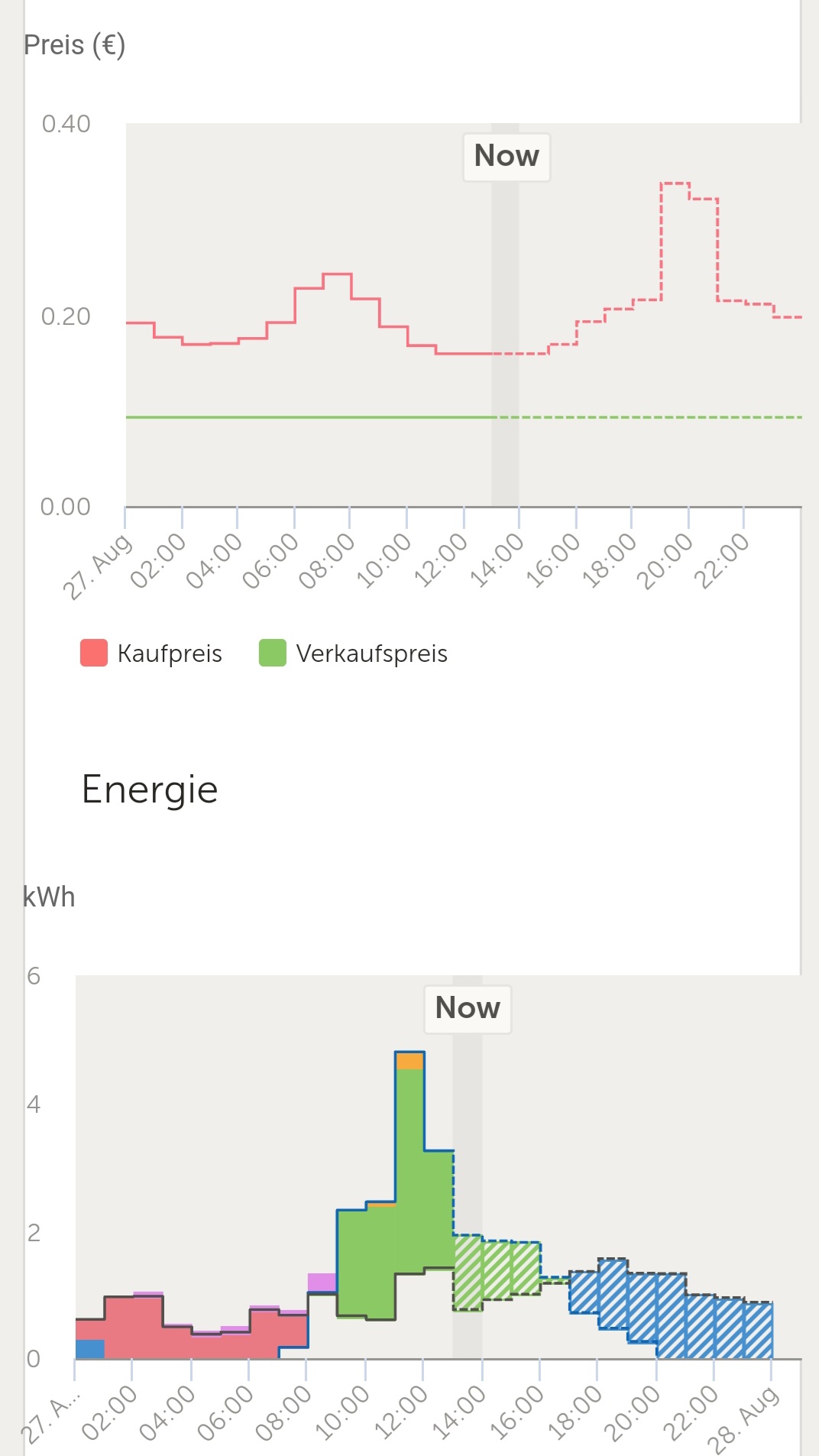

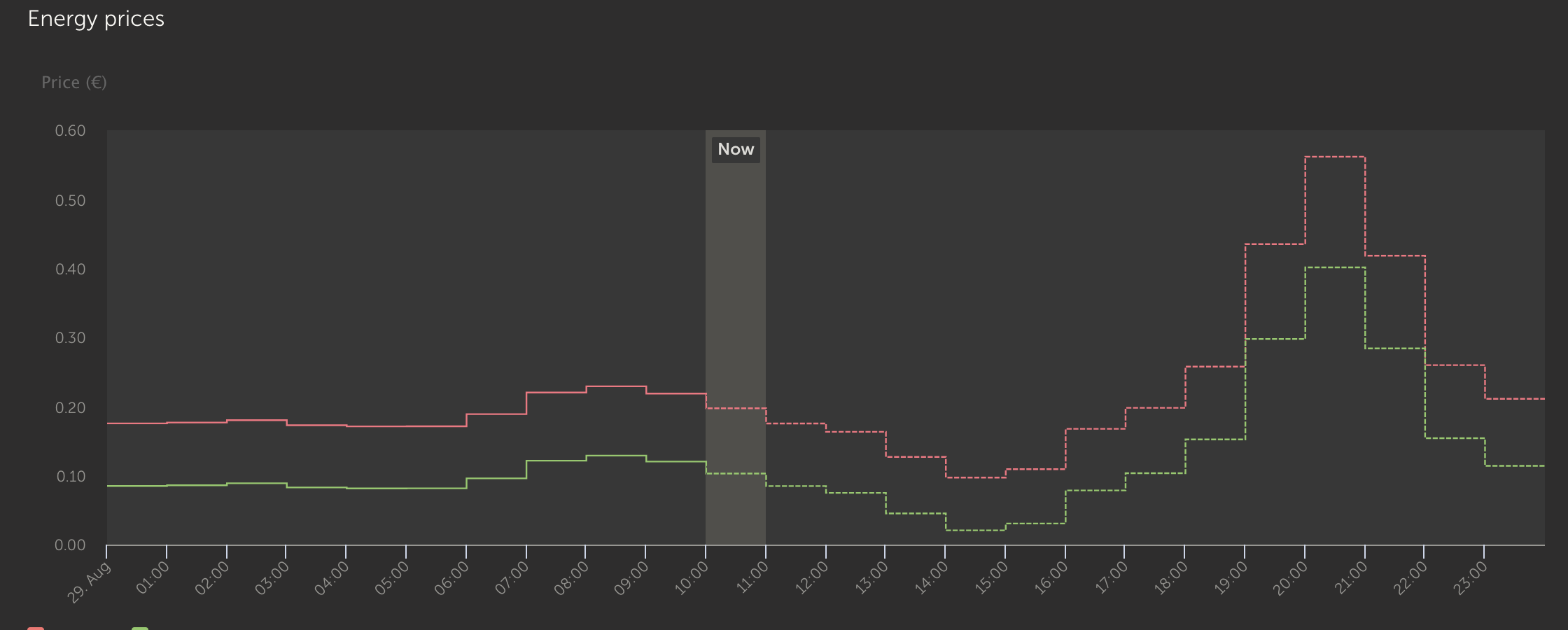

DESS in Green mode. Sell into grid 29.08 (02-03, 07-08)
VRM ID: c0619ab3c8b4
And we found another bug (and splashed it). Please refresh, that should fix it.

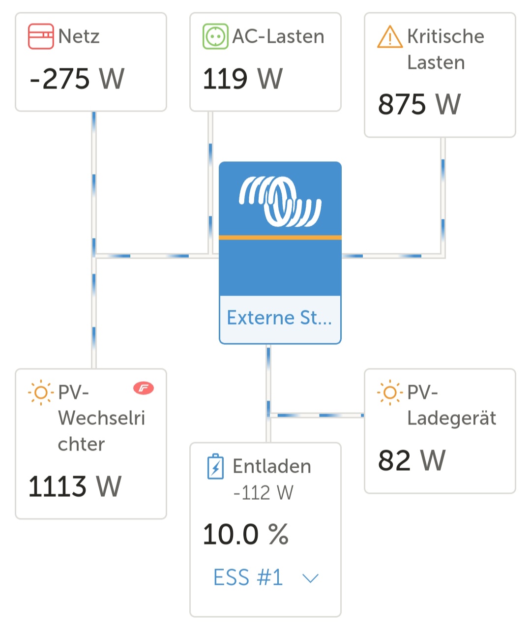

Hi,
my System als starts selling after enabling DESS and in green mode. ID c0619ab2dbac
bg, Nik
@netzweg Agreed, that doesn’t look logical. Looking into it.
@netzweg This was caused by an unexpected combination of circumstances on your system, which would have resolved itself when the new schedule (at the next full hour) would have started. But by that time, you had switched the system off again. We will need to make some changes to better cope with this for the future. If restrictions have been set, they should always have the highest priority.
Can you re-enable DESS just before the full hour and leave it running?
@netzweg Further info after consulting a colleague. If you look at all the data in your screenshot, the battery was just 300 W off covering the AC Loads and the PV was going into the grid. So it was really trying to keep to the restriction. The system always be slightly off, considering changes in loads.
It was wrong in not putting the PV into the battery, while being in Green mode, which it certainly would have started doing in the next hour.
Automated regression testing could help to prevent this.

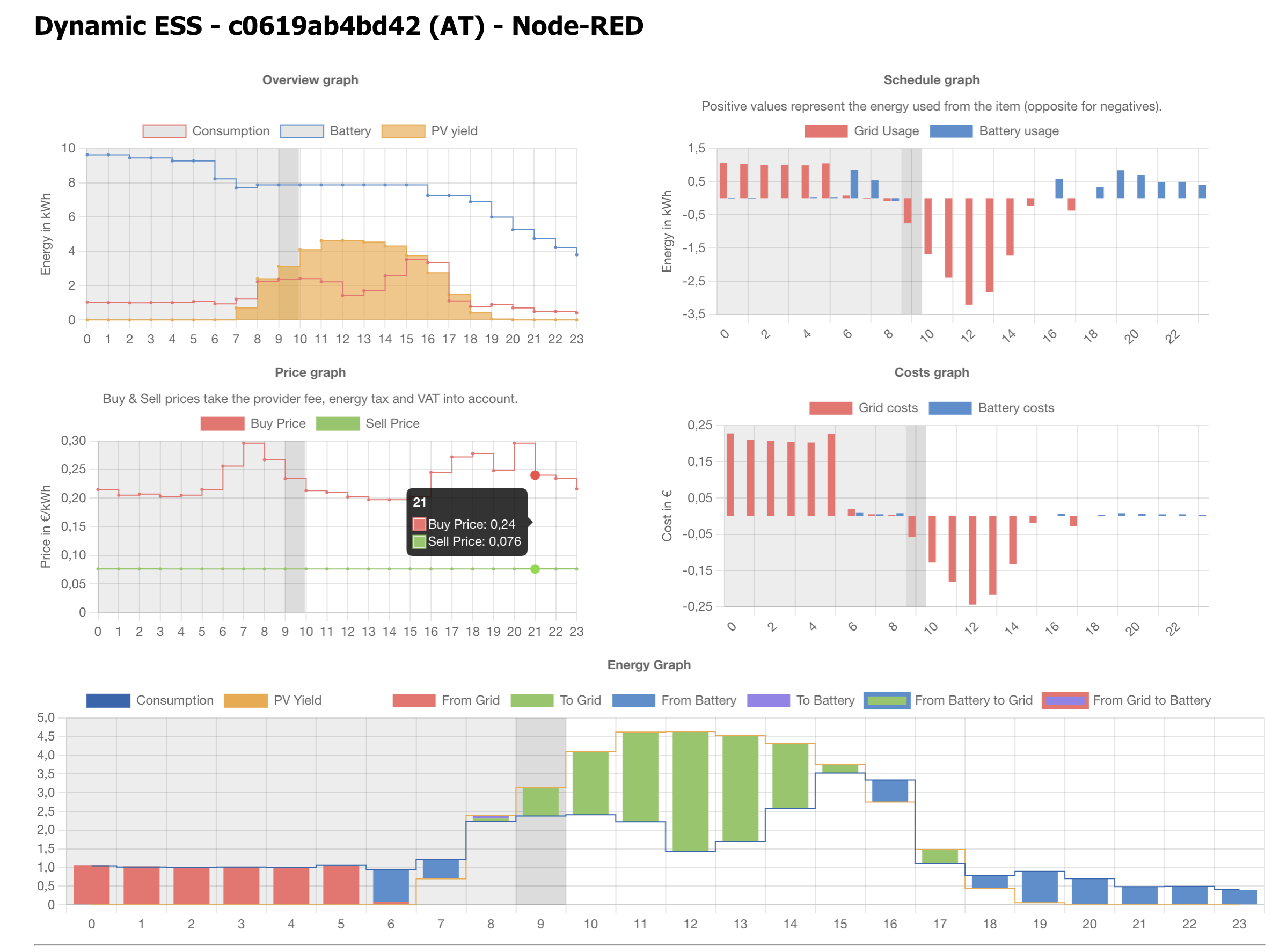

Hi, i have the same problem. Is there any solution?
Hi,
Here also the system wants to deliver energy at the grid.
I can not understand why, I only want to putt power on the gris when the battery is full.
Green mode activated.
Today again.
Green mode activated battery not full (<50%)
I do not understand, this is not green.
Is there any way we get a slider with a minimal soc for grid selling?
Say I set this slider to 85% and the prices are higher than a set price the system sell.
That would be very nice

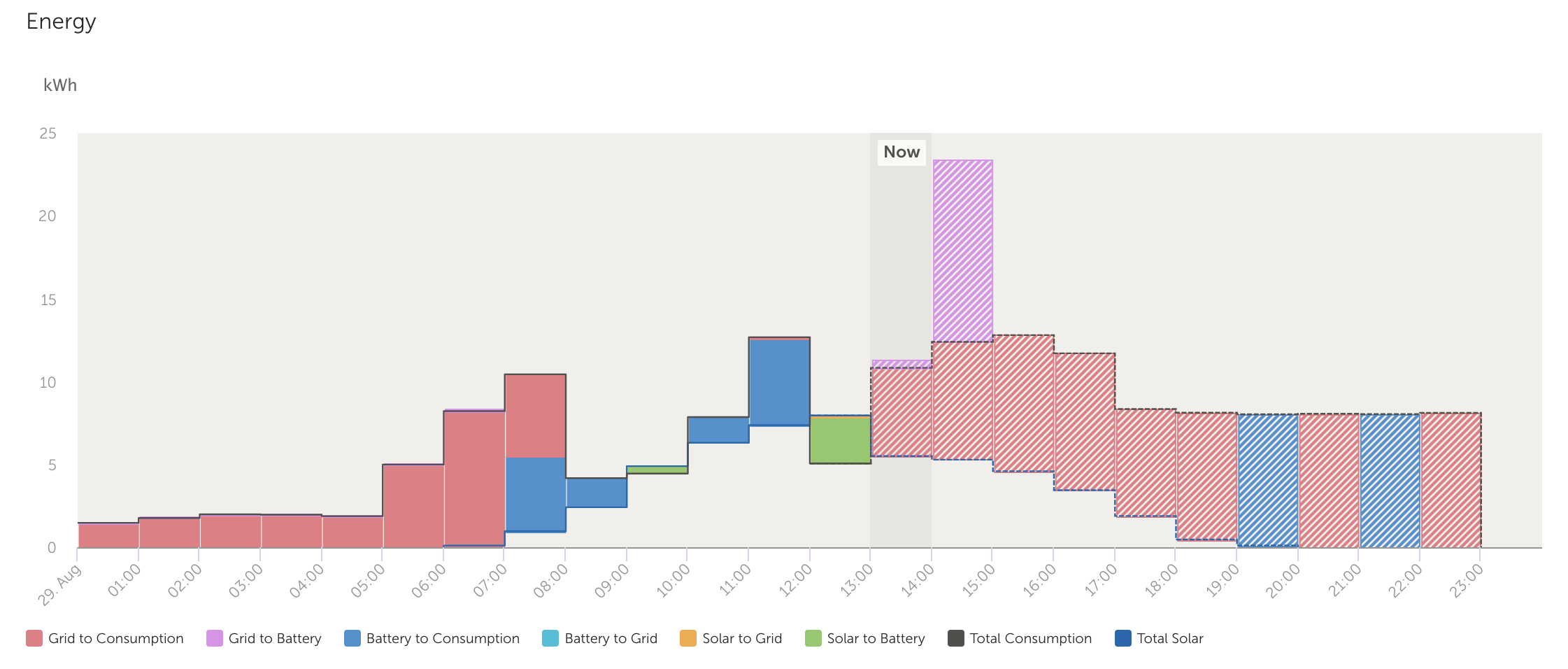

@dfaber I think there stills needs to be fixed something:
Sold half the day to the grid instead of charging the battery…
