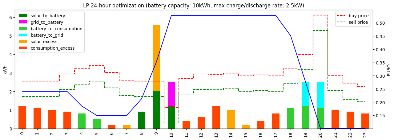

This LP algorithm minimizes total energy cost over any time horizon using consumption and solar forecasts, along with system parameters. The solver accounts for constraints such as battery capacity, maximum charge/discharge rates, conversion efficiency, cycle cost, and grid limits. For a 24-hour window, it solves in 1.78 ms ± 47.1 μs on my laptop. Though I do not plan to deploy it on the Cerbo, it will run on a dedicated server and be called frequently to adapt to changing consumption or low solar yields.
I still need to work out the details to control the Victron system with ModbusTCP and get the forecasting models. Any ideas?
The end goal is to hopefully implement sensitivity analysis to the solver. Some kind of system that could balance an optimal schedule with forecasting uncertainties. Also, this system can be made more robust with more auxiliary variables. It could automatically plan EV charging or a heat pump if they allow for external control. It should also be possible to let it schedule a generator. But that is all future talk. It does add to the complexity and would add to the solve time.

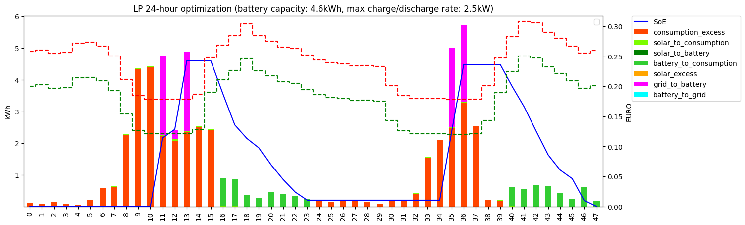

Please note that the solar_to_consumption is not plotted and the dark blue line is the expected SOC in kWh.

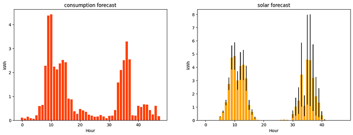

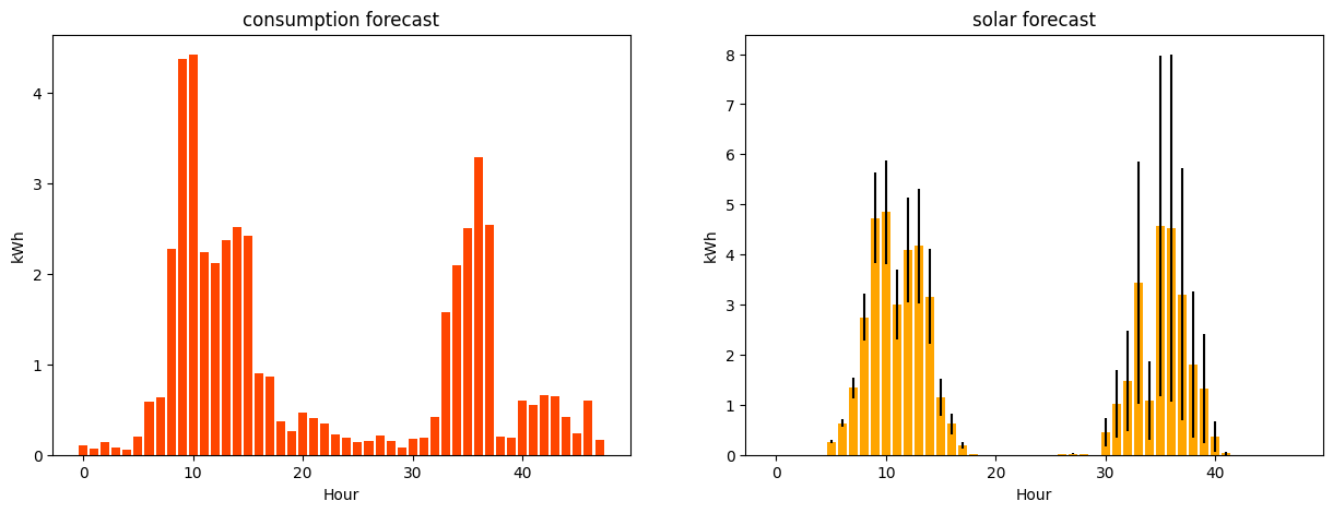

The battery has a 4.8 kWh capacity. Solving for the optimal solution for different levels of solar forecast:
The optimal solution depends on the available solar, but only to a certain extent—this sensitivity is influenced by the price. Even in scenarios where no solar generation is forecasted, the system eventually reaches a point where it begins charging from the grid.
No solar run

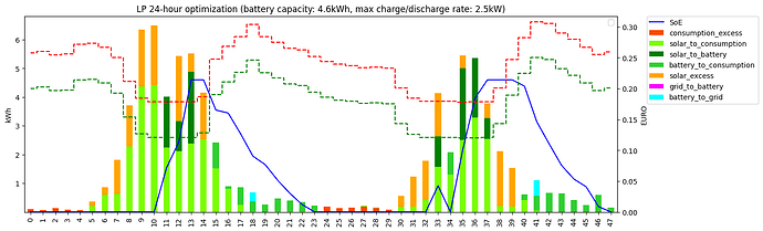

Optimal solar run
In between these two runs are a lot of solutions where the systems adjust the time of charge to accommodate the available solar energy. The sensitivity analysis graph can be seen as a min/max graph for the systems SoE.

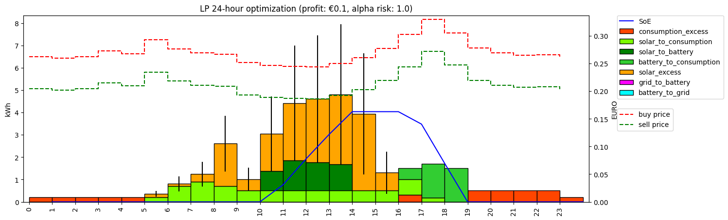

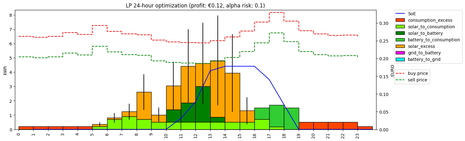

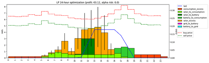

Hi Andrew thanks for showing interest :slight_smile: . This experiment is also only worked on when I have a bit of spare time. But I have a small update to share. After having a chat with an expert in the field of linear programming I moved away from sensitivity analysis and added an integrated risk function with a risk taking parameter called alpha.
With an alpha of 0 the solver ignores any uncertainties in the solar forecast, it focuses on price only:
With a small alpha the solver is nudged towards spreading the charging hours to other cheap ours:
with an alpha of 1 the solver assumes worst case scenario and plans accordingly:
The idea is that you tune alpha to your liking. Because alpha is integrated in the cost function it takes the price difference into account. A small alpha will quickly move charges to different hours if prices are close to each other, but will not change hours if one hour is particularly cheap (or others expensive). This is the balance I wanted when I said: “balance risk with profit”.
