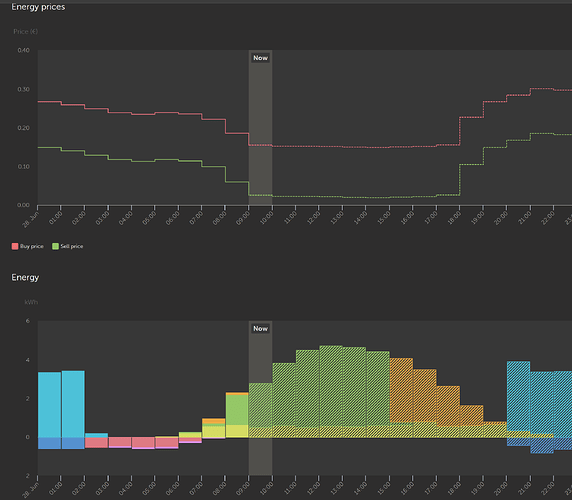

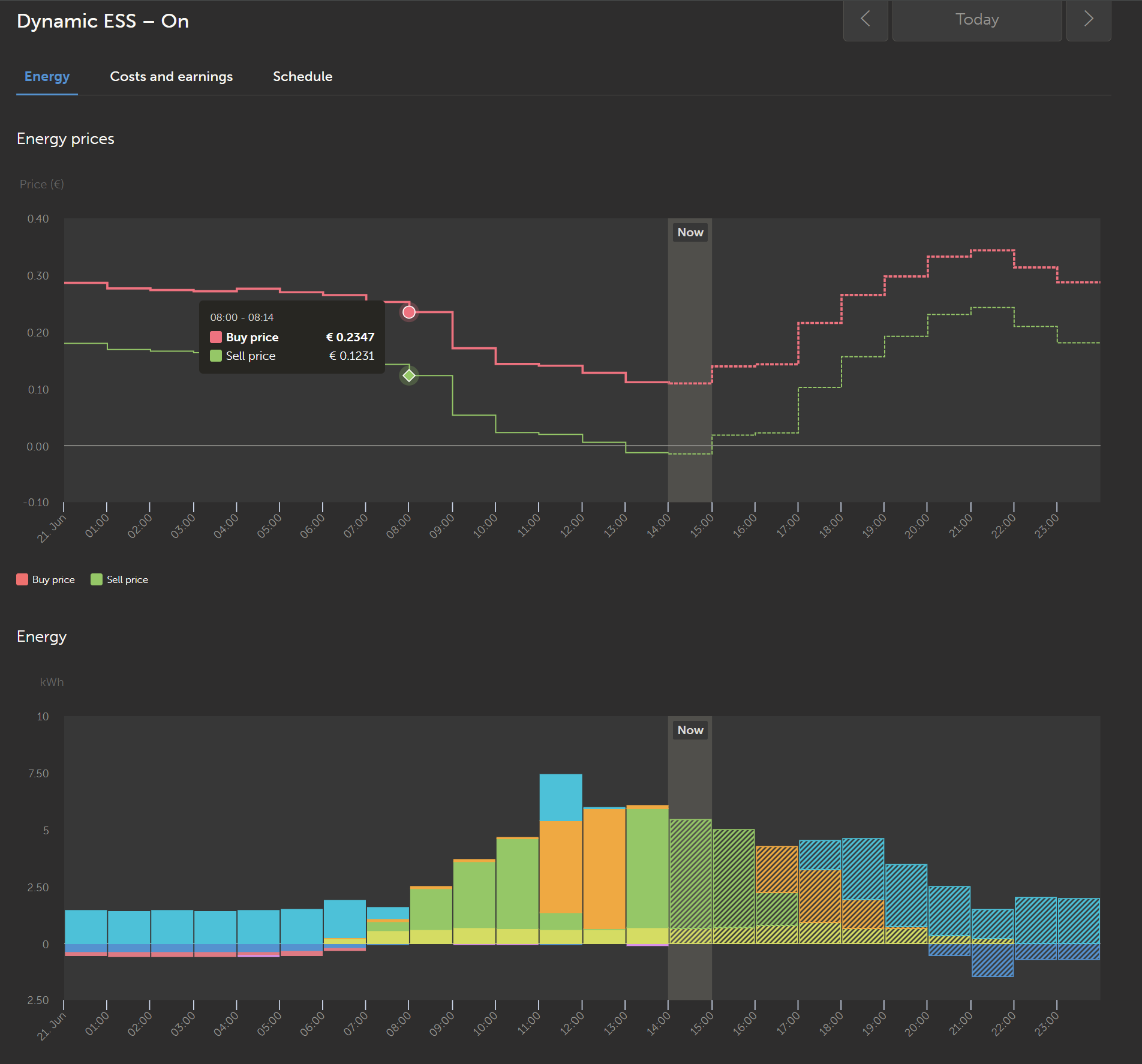

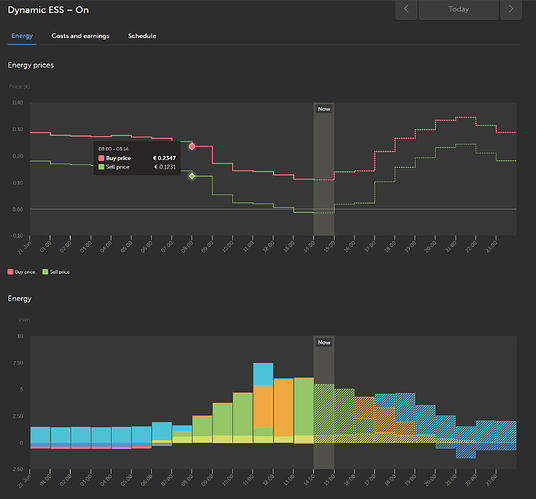

Today I saw very strange behaviour on my system. Can anyone explain:
- why is there consumption from grid while the intention is to push from battery to grid?
- why is there so much battery and solar to grid during period of low prices (11:00-13:00) while system is set to trade?
The schedule probably did this, to have enough capacity for the hours of negative prices.
Hence, during that time, your system could send all solar to the battery, avoiding you to have to pay for feedin, while still maximizing your solar yield throughout the day.
You mean during night? I could look at that in detail, but i’m quite sure, that your battery SoC is dropping faster than it should due to the calculated discharge rate.
Hence, your system will reach a certain target soc value to fast, probably every 15 minutes, and then switch to idle eventually.
That usually is caused by entering a “too big” battery capacity in VRM/DESS config. You probably went with manufacturers optimistic Capacity values there, rather than using the net capacity of the battery.
So, everytime DESS schedules your battery to discharge 4 % in 15 min, it actually reports to have discharged 4% after 12 minutes and then idles 3 minutes or something like that.
Tl;dr: lower the capacity setting in DESS to a value that makes this behaviour vanish.
(Also, having already degraded batteries ofc. Makes their real capacity smaller than what it’s labeled)

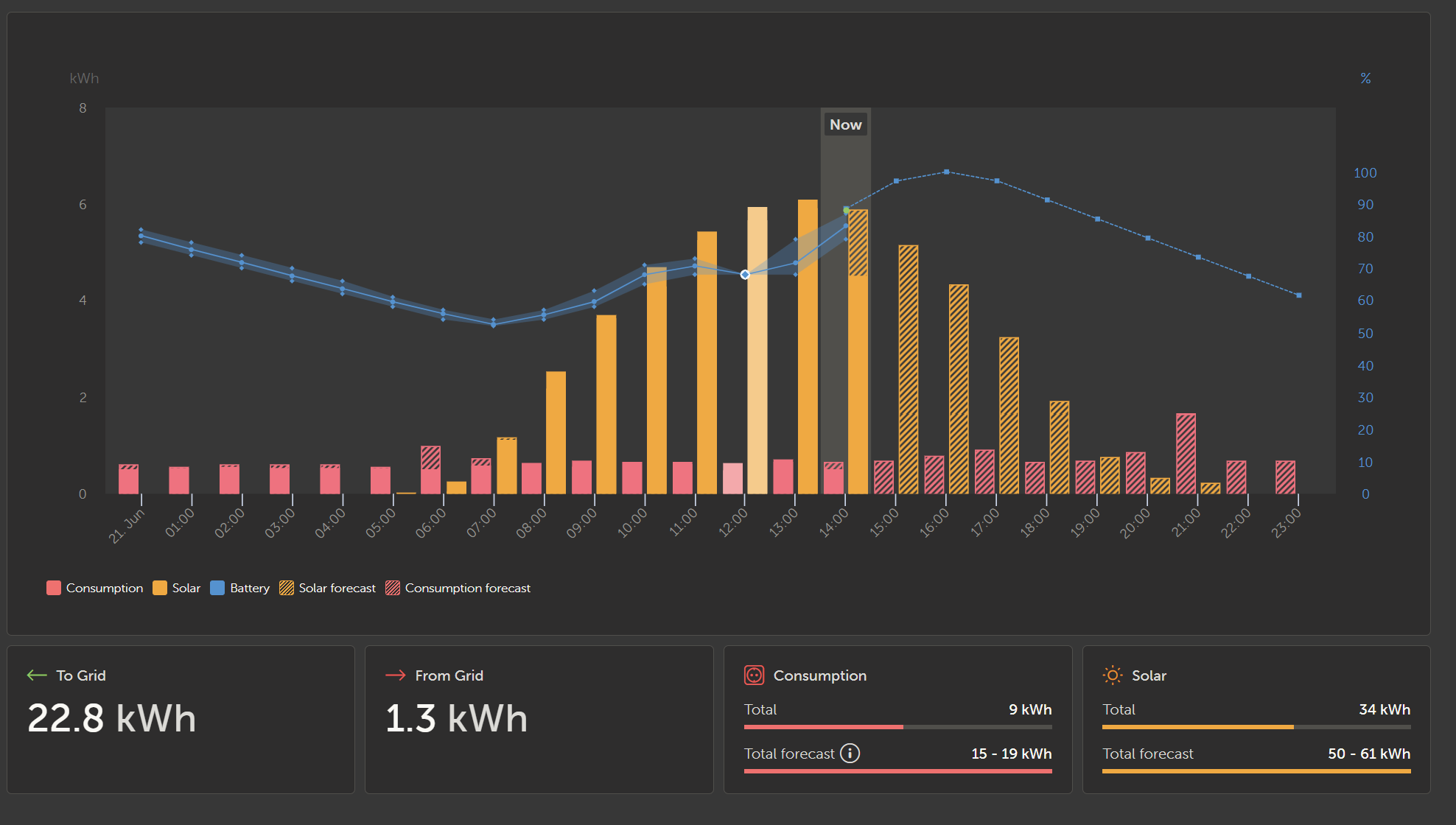

Hi dognose, thanks for your quick reply!
I can see what you mean, but the negative prices are known upfront so why did it not deplete the battery more during between 07:00 and 09:00 at a much better price! The system now also needed to sell surplus solar power at very low prices. The battery still had 50-60% SOC during that time. (my ess has minimal SOC setting of 10%).

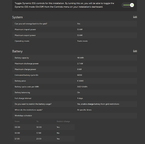

I think the battery capacity setting (48kWh) is on the low side already (for 314Ah cells 3*16 cells). But anyway, if think it would be better to not idle, but reduce the discharge during later hours to avoid taking power from grid. (e.g. recalculate the parameters every hour)
That is a good question, and when looking “back” at data an easy to spot decission that would have been better.
Probably, during the morning hours, solar forecast was lower, and the scheduler calculated, that 60% SoC, so 40% remaining is sufficent to cover the two negative hours.
Then, as time passed, solar forecast went up, so the scheduler decided it needs more empty space than initially assumed, hence decided to even feed in at low prices to ensure you don’t have to feedin while negative.
Forecasts always have some imprecissions and the further you “plan”, the more they sum up. 1% deviation per hour is roughly 15% in “now +10h”. So, the schedule will be continiously re-calculated every 15 Minutes.

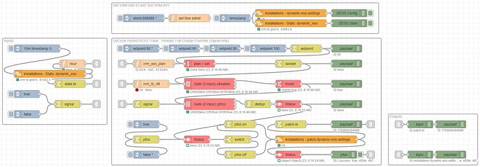

Here is a flow to set ‘periodic full charge override (balancing)’ by VRM-API.
Description:
- Top: set and test your VRM site Id (most likely not 888888).
- Left: three inputs, the first updates dess stats every 15 minutes and sends a timestamp when done, the second sends the current hour, the third sends a boolean value to enable or disable the ‘periodic full charge override (balancing)’ feature.
- Right: two outputs, the first a timestamp to indicate the ‘periodic full charge override (balancing)’ setting has been changed, the second the return of the VRM-API call to do that.
- Middle top two lines: Set and check for a maximum SoC to have been reached.
- Middle next two lines check whether the new (price) schedules have arrived.
- If the set maximum SoC target has been reached AND the new schedules are known, this flow disables (AND + Invert = NAND) the ‘periodic full charge override (balancing)’ setting under the assumption SoC is high enough and DESS has enough forward scheduling data to figure out the best way forward by itself.
- Middle last three lines: a hard On (true) or Off (false) inject node is combined with the automated override signal to turn the ‘periodic full charge override (balancing)’ feature On or Off. And outputs the result.
Example of use: Set a reasonable maximum SoC goal and change the true and false input inject nodes to act as timers, for instance ‘true’ at 11:00 dayly, ‘false’ at 17:00 dayly.
PS don’t forget to install the ‘node-red-contrib-boolean-logic-ultimate’ nodes before importing this flow (and all other required for VRM-API).
EDIT (v0.2): I made a small change to check for maximum SoC (Target) being reached every quarter of an hour (One could modify this to check the ‘Actual’ SoC as well, but that is for another day).
EDIT2 (v0.3): Included the ‘get stats’ API call in the input group (normally called in it’s own group in the parent flow). Now this flow should be ‘complete and functional’ standalone.
Tip: The results of the VRM-API calls are stored in the global context, a good place to start to reviewing what gets set and retrieved.
EDIT3: I mistakenly noted that this flow switches the ‘keep batteries charged’ feature while it actually switches the ‘periodic full charge override (balancing)’ feature. Both would work but the latter has the added benefit that DESS remains active and the graphs stay visible during the (few) hours that this feature is activated to force charging the batteries.
…flow deleted…

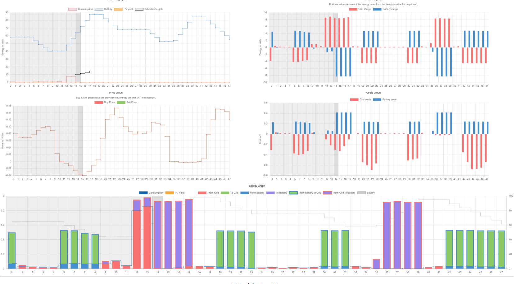

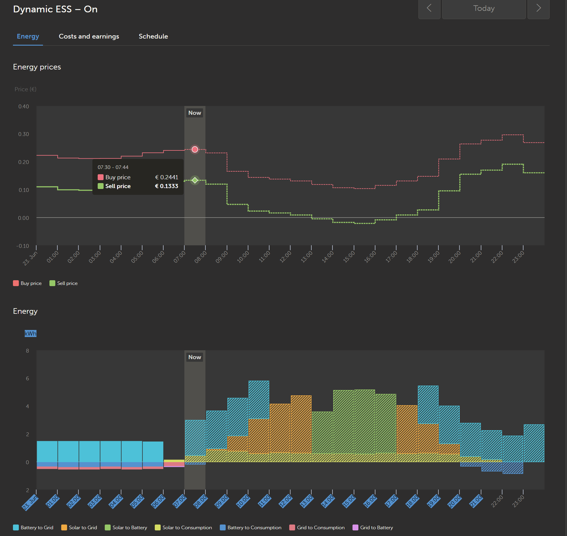

In the mean time here are the forecast for today. Note that the installation solar forecast differs dramatically from the DESS forecast…
Also the battery is not projected to be filled to 100% during the low price period while it can sell at high prices in the evening. This seems counter intuative…

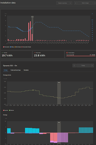

The current DESS Trade algorithm simply targets minimum SoC at the end of the know price forecast schedule. I agree that is counter intuitive (for a ‘Trade’ algo) when there are obvious ‘buy now sell later’ opportunities within that same day even.
Today you can try manually disabling ‘battery balancing’ / ‘keep batteries charged’ (same thing) in the morning, enabling it (set to every 2 days) right before 10:00 and disabling it again right before 18:00 to see what the effect is.
Can’t comment on the effect the solar production and unusual energy prices (big difference between buy and sell?). We use tibber dynamic prices where buy = sell. In general I think it best to set all settings as close to reality everywhere and let DESS do it’s work based on actual energy and battery costs.
Something to keep in mind is that a trade+solar system likes more battery capacity : prices are lowest when the sun shines hardest generally. DESS should (in theory) be aware that solar energy carries no marginal cost and only charge up from grid what solar can’t provide for free. And IMHO best with a dayly SoC target of full batteries around dinnertime
On our system we use the Node-RED DESS algorithm (running parallel but not controlling the scheduling itself) to decide when to turn on and off the ‘periodic full charge override (balancing)’ setting (in VRM DESS). It has a function (missing in VRM DESS) to set an additional b_goal_SOC (95%) and b_goal_hour (18:00) target for the day and then calculates when best to start charging during low prices. (is there any reason why this is not enabled in VRM DESS while it works in Node-RED DESS @dognose ? Enabling this, even if only by API call, would make a big difference I believe (but much more elegant by enabling the scheduled charge levels while running DESS). And on another note: is there a way other than polling stats every 15m to get a push message when the schedule gets changed/updated at the VRM-API endpoint?)
Without that, we would have the same problem:

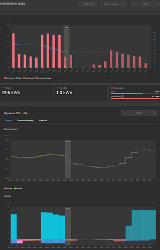

And this is the result after enabling ‘periodic full charge override (balancing)’ from 12:00 (automatic On by Node-RED DESS trigger) until 14:00 (automatic Off after pricing for next day rolled in AND target SoC above 70% as was our current setting). As visible, VRM DESS is continuing to charge even with ‘periodic full charge override (balancing)’ Off because it now targets minimum SoC for the end of day tomorrow (instead of today). From here on: Rince and Repeat.
The rational for this ‘intervention’ is to enable DESS to start charging already before the ‘next day’ pricing schedule rolls in (between 13:00 and 14:00 normally. Without this intervention DESS will always miss all buying opportunities before the next day prices are available, which is a significant opportunity miss if not corrected for.
It would be nice if VRM DESS could also take in consideration b_goal_SOC and b_goal_hour for the next day, as visible in the Node-RED graphs. But that isn’t a hard requirement because come tomorrow it will simply get triggerred to enable ‘keep batteries charged’ at the optimal moment again:
That said, the charm of this workaround is (IMHO) that it interferes minimally with the regular operation of DESS: only during those hours before the new prices roll in it may (or may not) nudge DESS to start charging a couple of hours earlier. The rest of the day it doesn’t interfere with normal DESS operation at all. I hope this will make it suitable for systems with solar involved as well, or even in combination with DESS Green (instead of Trade) but I have not tested with either yet.

I installed the 0.3 version. Not sure if I configured it properly but will see (also send you an email that I found in the 'Phasing out… thread). If you have a newer/better version please let me know s I can install it…
That should work. The true / false ‘inject’ inputs can be edited to ‘fire’ at preset times, that’s a good starting point. I tried to keep most logic transparent by using nodes instead of functions with code for better visibility. Once you got VRM-API working and figured out where to find the debug window and the flow / global context variables you should be able to just ‘follow the flow’ and investigate what the nodes do. All is pretty well documented in the help system for all those nodes.

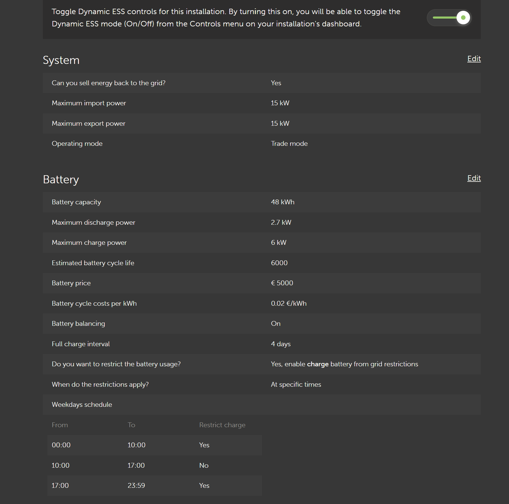

From the settings you already showed I’d advise to revisit all your other VRM DESS settings and turn restrictions off and set any settings to actual values as much as possible. I saw a big difference between buy and sell prices with a low battery cost, unless that is actually the case you can better adjust those to correct prices and higher battery cost.
Let me know what works, or not, and post your settings when you have questions. Next step is to get Node-RED DESS involved to choose when to turn on and off PFCO.

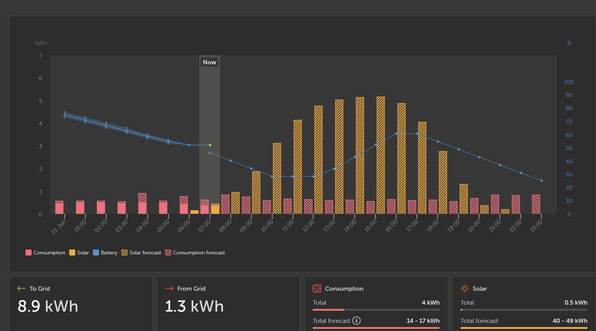

It is not improving.
Changed to green mode. Limit discharge to 4kW.
Why again limit discharging to 59% at high speed (it is asif the 4kw discharge limt is seen as a fixed discharge rate when DESS thinks it needs to discharge.) during the first hours of the night and then needing to get energie from the grid! This is costing me a lot, relatively. Sell price is much lower that buy price, so why not distribute charging across the night hours?
The reason for using batteries and DESS is to limit taking energy from the grid as much as possible!
