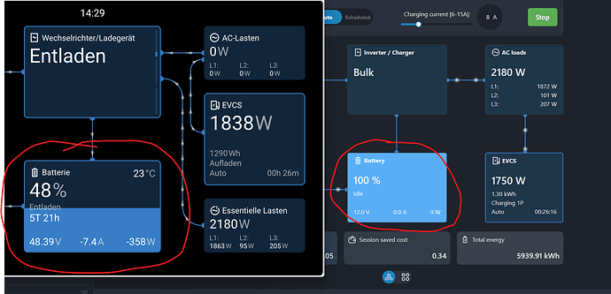

Hi,
my EVCS is showing the wrong SOC, resulting in strange Automode behavior.
It always shows 100%.
EVCS firmware: 2.04
Cerbo firmware: 3.66
It seems that communication between Cerbo and EVCS is fine.
Any idea what could be wrong?
that’s because you have enabled the virtual battery. Check the EVCS settings
Ok, I assume you ment “Backup battery emulation”, well that solved the issue, thanks.
