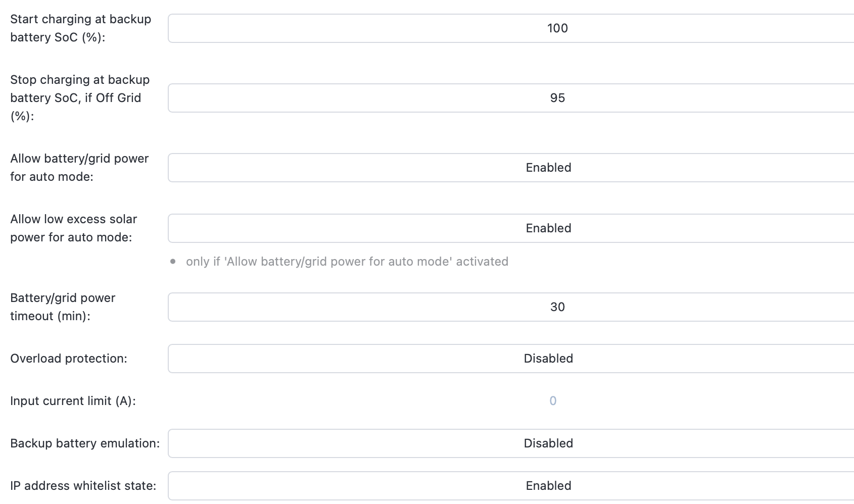

Here’s my current settings…

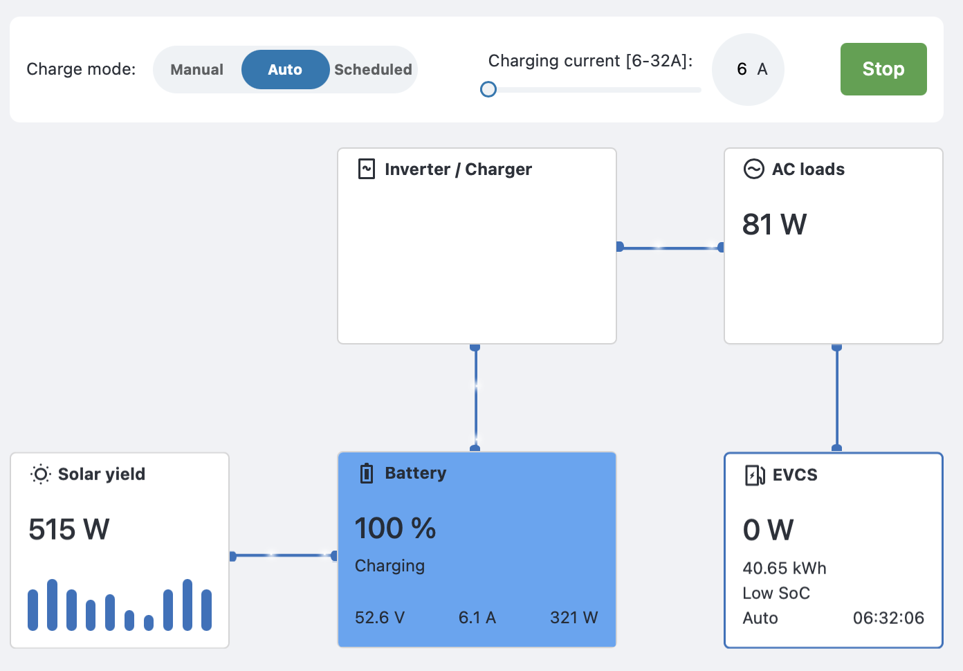

And here’s an example of the Dashboard of the EVCS stuck on “Low SOC” while the SOC is in fact at 100%
Just out of curiosity - what’s the firmware versions involved (EVCS/GX device), and will it start if you change 100% to say 98% ?
It will start OVER the configured SOC.
You set it to 100% so it needs to get to 101% which doesn’t work.
Try setting it a bit lower.
:see_no_evil_monkey: soo simple…FIXED! Thanks Matthias!
