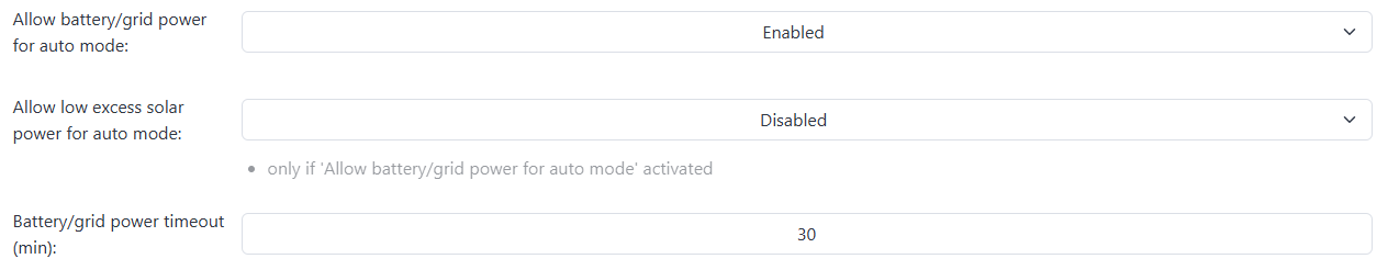

I have “Allow battery/grid power for auto mode” turned on with 30 minute timeout and “Allow low excess solar power for auto mode” turned off. I would then expect the charging to only start at ~1300W surplus (measured battery charging). But once it starts it should continue for 30 minutes after PV drops too low, no?

Update: If I read the Excel Sheet with Modbus registers, I think 600W Backup Battery charging power is the normal threshold to start (500W “balance power” + 100W “Available sun power threshold for start”). But with “Allow low excess solar power for auto mode” turned off I would expect it not to start?
