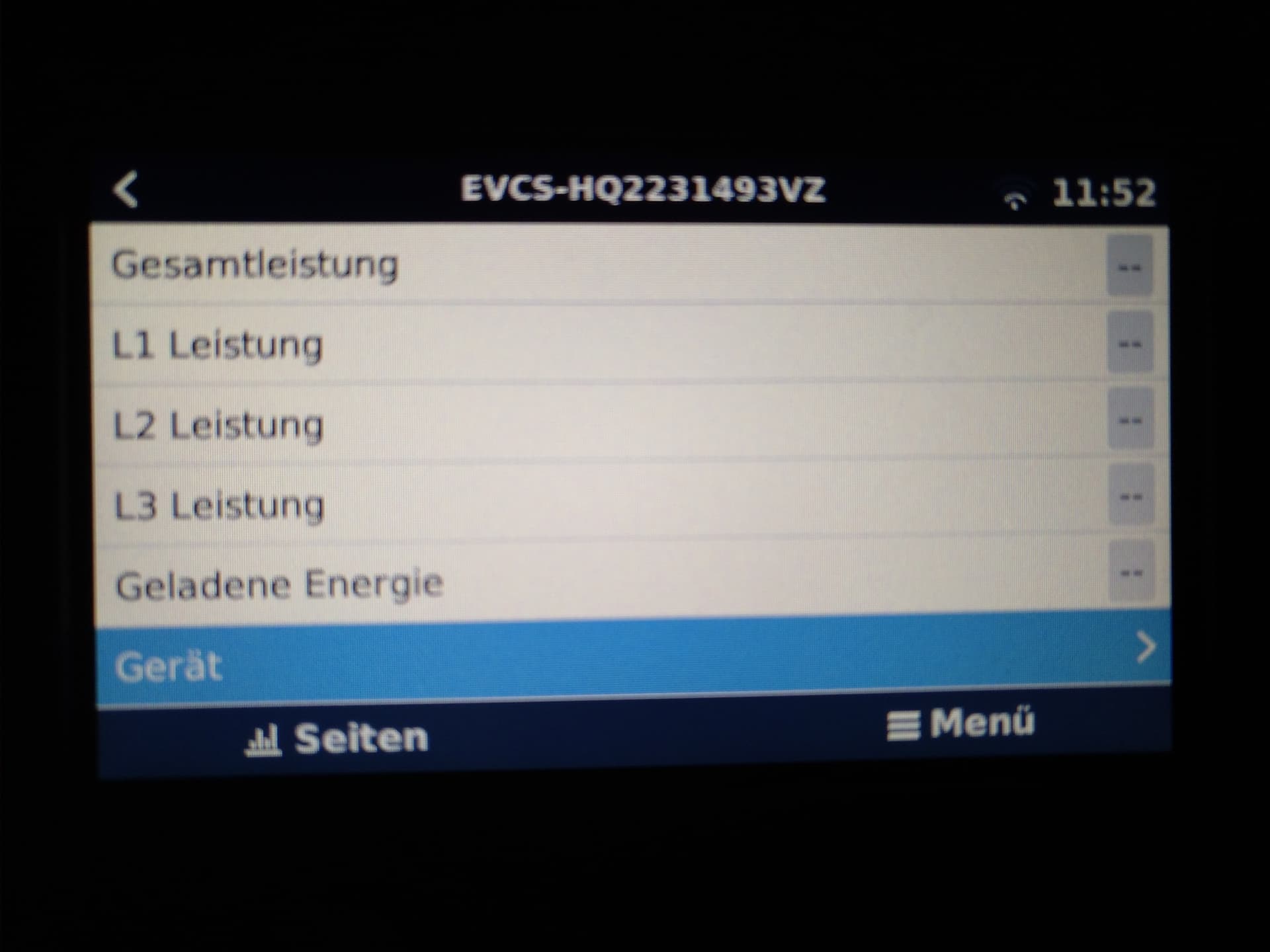

The problem is that it has been going for two years and suddenly the EVCS has disappeared from the device list. I have now done another scan for the devices. But as you can see from the photo, nothing has changed. The EVCS has disappeared.
Even after the scan it does not appear in the list.
All devices are up to date with the latest firmware. But with the VRM I already had the error message that there was a connection problem. But everything worked.
A few days ago, the EVCS was still in the list and was shown as not connected, but this was not the case. I was able to start charging via VRM and switch from Auto to Manual. But it was still in the list.
Access Point was set in the network settings, I changed it to Station and now the EVCS is back in the device list. But as not connected. like the old photo above
Everything works again, the network settings were configured incorrectly.
