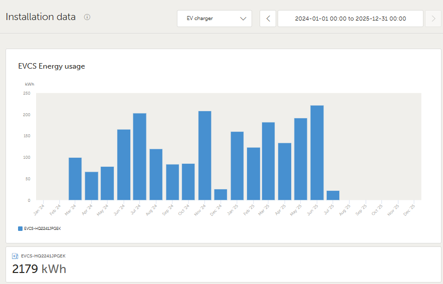

since 2 days, the energy charged is wrong on VRM “instalation Data”

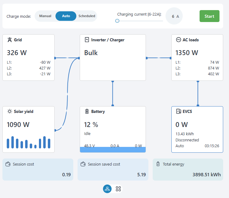

the correct energy (3.1kwh) appear into EV station table and on the EV Station page
graph count energy with correct value. (7kw)

Same issue here… I think I need to find a more stable way to log my energy sessions, so I can correctly do the chargeback to my company… Currently, I need it on VRM, to see the total per year, as that is beeing used for the chargeback
In VRM: 2179 kWh
On EVCS: 3898 Kwh
My wifi AP, is just about 3m away from the EVCS @ -61dbm, so is generaly considered as a good reception (-50 dBm and -67 dBm)
